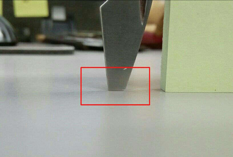

The flat head screwdriver tip on the cap lifter is angled awkwardly toward the backspring. So because of the angle, applying pressure to tighten a screw will collapse the cap lifter / driver closed. I think you can see it in this photo. I will probably end up grinding it flat or angled in the other direction.

Huh. I would never have caught that in a photo! Your hands-on feedback about this knife is greatly appreciated. :)
Interesting pic jrawk, can any other GP owners check theirs and chime in if this is inherent in the design?
They're just punched out so my GUESS is that they're all the same. Hopefully, folks that own the knives can chime in. BUT it would seriously just take a few seconds to grind it at a better angle. For me, that would be a non issue.

With knives that are assembled with peened pins, a screwdriver is really only good for light duty. Any heavy twisting could loosen up the pinned construction. The same is true for an awl/punch since it's also used by applying torque.
Mine's got it too. I wouldn't use it (or any knife) for any heavy duty unscrewin' but it would definitely work in a pinch. I need the phillips on my keychain SAK way more than a flat head.

The primary concern here is not that it's easy to file or grind down the driver end, it's that the dimensions change slightly. The thickness may no longer be uniform (think what would happen if you cross-sectioned a blade at an offset angle), so now you're stuck with what is essentially a trapezoidal driver surface that requires grinding down the sides as well. Now you're getting into some serious material removal and mistakes can be made. Plus I'm pretty sure any warranty would be voided at that point.
I've gotta say, this might be a dealbreaker if making it "right" takes as much work as I'm thinking it could. I really do have to see one up close and personal now. I am interested in the question about the spring tension, too. Being a Barlow, I'd hope the GP snaps like a gator in both directions like almost all of my regular #69s.
Maybe jrawk can give a measurement with the micrometer that he used previously but from his photo it looks like we are talking about a very small amount. Also these are definitely not hollow ground screwdrivers that are designed for an exact fit. They're just punched out from stock. They do have a taper but I'd be surprised if a small amount of grinding would affect the size much. I suppose, you could adjust that as well. We very likely are over thinking it.
Also, I would be shocked if Queen wouldn't honor a warranty if the very end of the screwdriver was ground flat by the user. You shouldn't return it to a dealer afterwards but I see no reason that it would affect warranty repair from Queen. You could email them an ask.

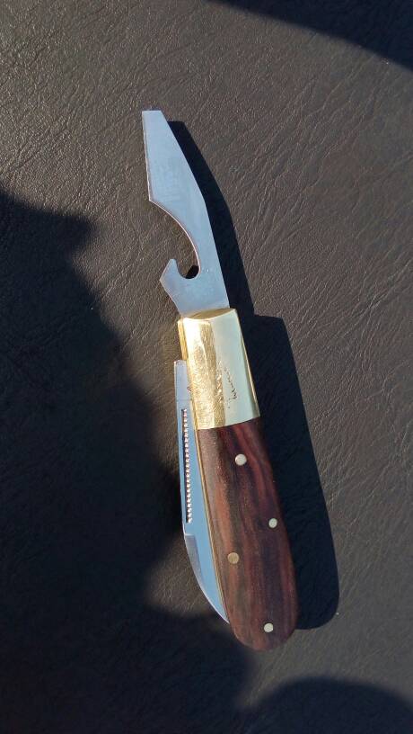

Knife content: My two latest wood-handled Barlow acquisitions, along for the ride today for moral support as I seriously ponder the prospect of getting a GP.
