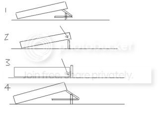

This is just from my personal experience and observations... but if you place the figure 4 mechanism directly under the deadfall there is a chance that the weight will either get hung up or redirected, by the vertical support, when tripped. I don't sink the horizontal post into the ground but on occasion have had it get caught. Anybody else experience this or is it my bad engineering skills. Please excuse the poor drawing.
1 - the fig4 directly under the deadfall.
2 - The tripped trap with the horizontal post hung up.
3 - Post placement prior to setting the trap
4 - Fig4 set with post out of the way.

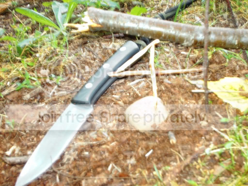

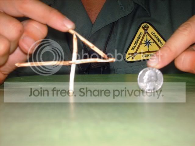

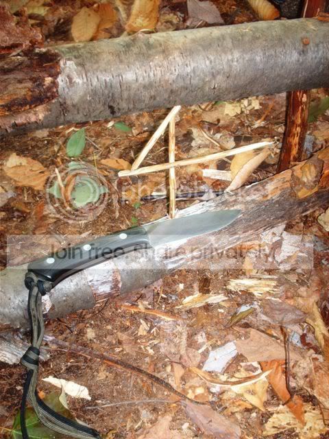

Here are a few figure 4's I made this past week in the woods. It seems as if they became significantly smaller with each one I made. All functioned flawlessly. If properly constructed, the pieces will spring out of the way of the falling weight. The last one was a challenge but it was cool to see work.
Next to a Chris Reeve Knives Jereboam
Next to a Bark River Knife and Tool Fox River
Next to that same Fox River
Next to a quarter
Great work K.... looks good. Is there a reason why you strip off all the bark on the trigger pieces, and what sort of animals have you caught with these?

I strip the bark to get right down to the hard wood. It is also an asthetic thing to me. I just like the looks of it. Also, if the wood happens to be somewhat green, it will help it dry out a bit faster.
I haven't caught anything with the traps I made this past week. Those were made for fun and I didn't need to trap anything with a ready source of food nearby. In the past, I've caught some backyard pests with traps like ground squirrels and field mice with crushed up nuts. Now, I can't justify trapping and killing an animal just for fun. I know I can do it but that won't stop me from practicing making traps and sharing how its done with others.
