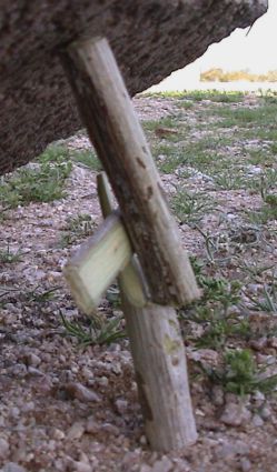

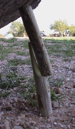

I saw the first page of this thread before heading off to the beach for a day of lifeguarding. It was a cloudy, cool day and the beach was almost empty the whole time. After a while, I remembered that I'd seen this this morning, and walked around finding some sticks to work with, and a 2''x12''x2' piece of lumber that had washed up.
I built a figure 4, and though its trigger was a bit sensative, it functioned perfectly on the first setup attempt.
making traps is a fun skill and way to amuse yourself, and today it gave me a reason to try out the new mora :thumbup:
scandi grinds really are nice for woodscraft!

Pict, the trigger stick barely looks braced on the dead fall support.
How did you do that?
