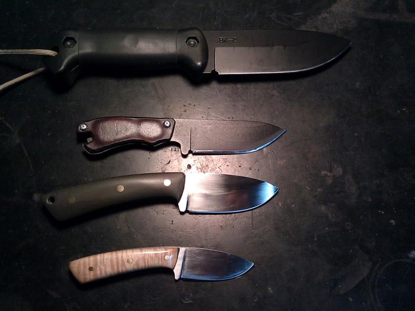

My BK2 is my favorite "big" knife.
But in the EDC and practical use arena, the tweeners are gonna have some stiff competition for my attention from my own knives, which are finally maturing. I really like 'em. The bottom two are my new EDC belt knives:
More pix of the green-handled one over here:
http://www.bladeforums.com/forums/s...-hunter-and-a-milestone?p=9743099#post9743099
(Oregon, you're a serious dude for shaping so much micarta, I gotta say. Impressive)

Are those leather grips on the Necker?

They are, on a D2 Camillus.
Pressed around wood fillers in the tang which give it a bit more thickness and texture.

actually at first I pressed the leather to the handle without the wood fillers, and they conformed slightly to the handle with concave surfaces over the tang cut-outs. Neat, but I wasn't entirely happy. So then I fit some poplar scraps to the holes and pressed the leather again, but now got convex sides. Since the leather was originally sized to the tang without the fillers, the final result was that the leather is a bit shy of the edge of the handle all the way around, but not in a bad way. The front of the leather scales mate up with the opening of the Camillus kydex sheath, hence the odd length.
Ultimately I decided the BK11 is too much blade, not enough handle, so the best way to make it most comfortable and usable was to build that green knife in the picture.

Both sets are things to be coveted for sure. Superb work.
