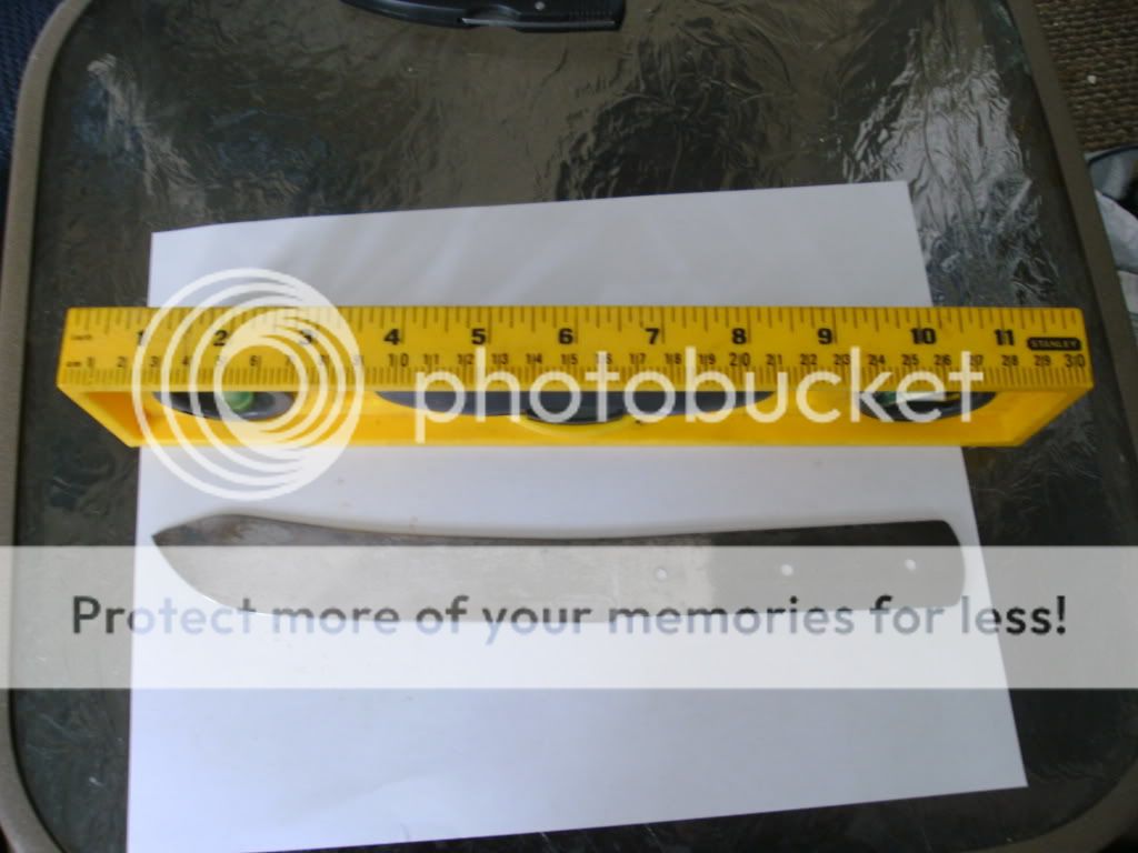

Hi all, I have a question pertaining to tinkering with a knife.
The knife in question is a Dexter-Russell Traditional 6 in. Butcher (just under 10 1/2 in. overall, exactly 1/5 cm at the thickest), it's has a profile of something between a trailing point (in that it's upswept) and a clip point, and a drop point, the curve goes from tip to butt, it decreases after hitting the balance point, which happens to be at the very edge of the handle. The handle still curves though, just enough to make it annoying to hold.

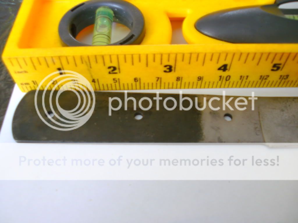

So, my question is, how would I go about reshaping this knife into a drop point with a perfectly flat spine and leveling the handle? Also, how would I go about skeletonizing the handle between the pin holes?
Also it seems that the previous heat treat was ruined, I determined this from the discoloration at either end of the knife, butt and tip. I do not know what grade of steel it is, but according to the Dexter-Russel site, it is made of either stain-free high carbon or classic high carbon, no actual grade is given.
I would like to give it either a convex or scandi edge as well.
Thank you in advance for any advice and/or help you can offer.
Edit: I will have pictures of it up soon.
Edit 2: I have pictures. Sorry if they're blurry, I get shaky hands when I haven't eaten in a while...

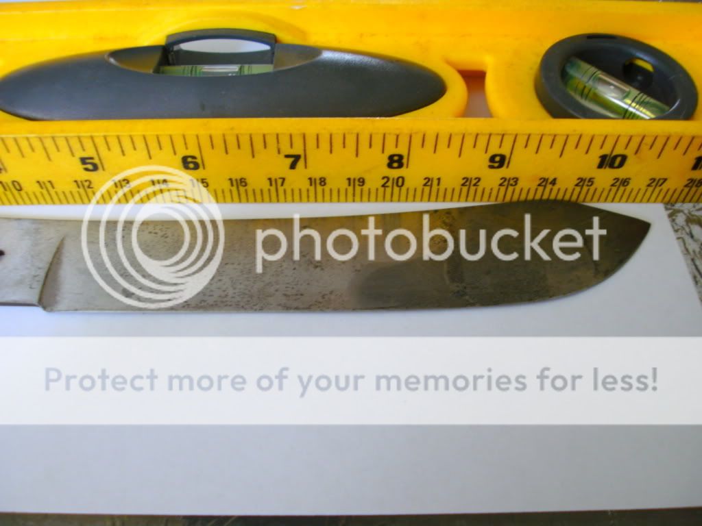

Thank you. I just did a test recommended by Richard, thank you by the way, and found that one part of the cutting edge has an at least degraded heat-treat, the steel didn't roll, but it did bend, there is a bend in the edge, I will post a picture of it soon. Until then it looks like if you were to take a diamond dusted steel rod and pried it against the edge until it created an indentation on one side and a lump on the other.
Until I can get a decent picture of it here is a dash and arrow diagram: ______________/\_____________________
It's not a chip, it looks almost pushed....
Sorry for the double post but I got a half decent picture and I modified it to make the 'bump', as I've been calling it, as visible as possible, all I did to it was increase the black and white levels to show more contrast. Here is the picture, the arrow points to the 'bump'.
i'm still curious to see how it does with an edge. i'm betting it will need to be re heat treated.
So, what's the verdict? At the risk of sounding newer than I am (that's hard to do, but it's still possible...) what should I next? So far I've determined that I have a knife with a heat-treatment ruined in one spot...... The only thing I know how to do at this point is run sand paper and a file along the knife to shape it....
Should I sand/file it down before I heat treat it, if I even have to actually heat treat the whole thing?
It seems as though the knife is a little softer than when it came from the factory. If you have a vise, pad the jaws and use it to hold the blade while filing. Or if you have some clamps you might be able to clamp it between a couple of boards while filing. Show a picture after it is profiled.
