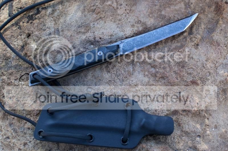

I go to finish with 45x gator belt then etch in FC for about 3 minutes then into the tumbler for about 3 minutes to get this finish. All are 1084.
Cool mark. Ambush?
I've actually been looking into similar symbols for my mark. Not the "ambush" one specifically but other battlefield/navigation symbols.
