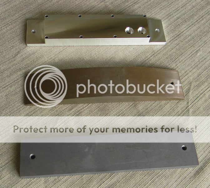

36" and 48" radius platens, water cooled aluminum platen chillers, hard flat platens to fit TW-90.
The platens are sold out.
The radius platens are machined of A2 steel and hardened to HRC 63. The flat platens are D2 and hardened to HRC 62. These have all received cryo. They're 9.25" long and 8.0" center to center mounting holes.
Radius platens are $125, flats are $100, chillers are $70. Flat rate shipping in the USA is $10.
There are four 36" platens, nine 48" and four flats.
The radius platens simulate 3', 4' wheels.
In using the radius platens I have found the effect is subtle, but noticeable. It isn't a flat grind, but it isn't really a hollow grind. I believe this is a historically accurate grind for blades ground in yesteryear on really big stones. This is a cool grind for blades made in an older style, and blades like kitchen knives where you would want a full height grind on a tall thin blade.
The water cooled platen chiller is a very useful gizmo. You just about need one if you're grinding with a belt warped around a formed platen, but even folks doing regular flat grinding have found these to be very useful. I've gotten a lot of great feedback about these and I use mine all the time and wouldn't want to be without it. Grinding against a cool platen is a good thing.
These have an internal meandering water path circuit where you can pump, siphon or otherwise flow water to control the temperature of your platen. I use ice water and get mine cold.
The mating surface is precision machined flat and the back of my steel platens are also precision machined flat so you can simply bolt these up and get fairly decent heat transfer. For better heat transfer or to use a platen I didn't manufacture you can use a little thermal grease during assembly to get really good heat transfer.
KMG tool arm shown. However this sale is for TW-90 grinder gear.
The chillers are sealed with a buna N o-ring that is rated to 250 F. The assembly can be opened to remove clogs. If opened, you should use a little smear of grease to lubricate the o-ring upon reassembly.
The pipe thread is a standard 1/4 NPT. You are responsible for hooking up your own coolant supply. I recommend swivel push-to-connect fittings and 1/4" or 3/8" plastic tubing, though rubber hose and hose barbs work too. I'm using a dinky little centrifugal pump here and a bucket of water. The meandering coolant path in the platen chiller induces a lot of turbulence in the water flow which helps you get good heat extraction without needing a lot of water flow. An aquarium pump is adequate. Or you might opt to hook up to your regular water supply and simply dump the water (though you'll go to hell for wasting water). Just remember you don't need huge flow or pressure here. Keep up with your tubing to keep it out of the grinder wheels and mechanism using zip ties or similar.
These are ~ 9" long and 8.0" center to center mounting holes for the TW-90 grinder. If these platens will fit your grinder and you would like to buy one of these, I need you to please follow these instructions to help me keep up with everything (otherwise folks will fall through the cracks).
