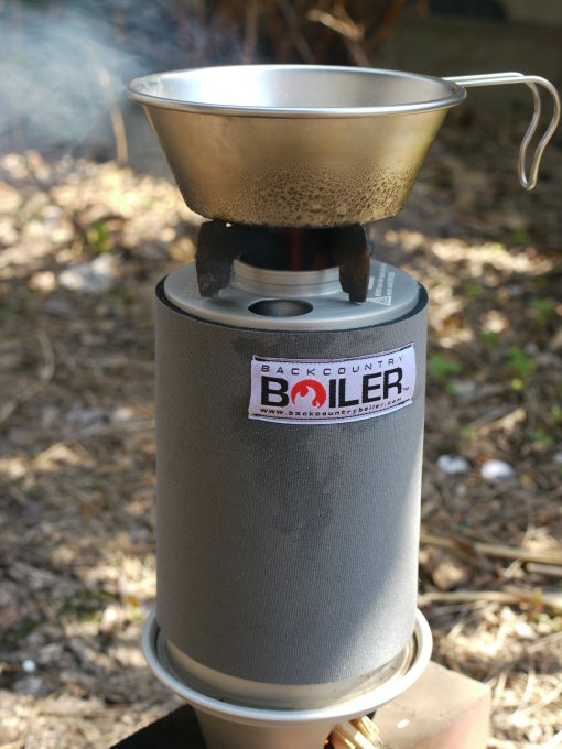

The other nice thing about the Backcountry Boiler, is that whilst the water get's hot, you can utilize the chimney effect to cook or heat even more water.
Credit: ulgoods.exblog.jp
Here's a video showing how a little strip of chicken wire can make a useful pot support. This video also shows the use of hexi tabs in the Backcountry Boiler.
http://youtu.be/8B8-7dGDbmk
