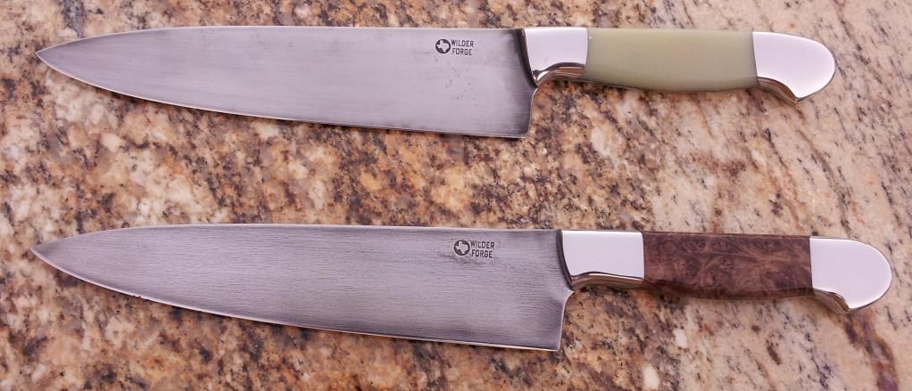

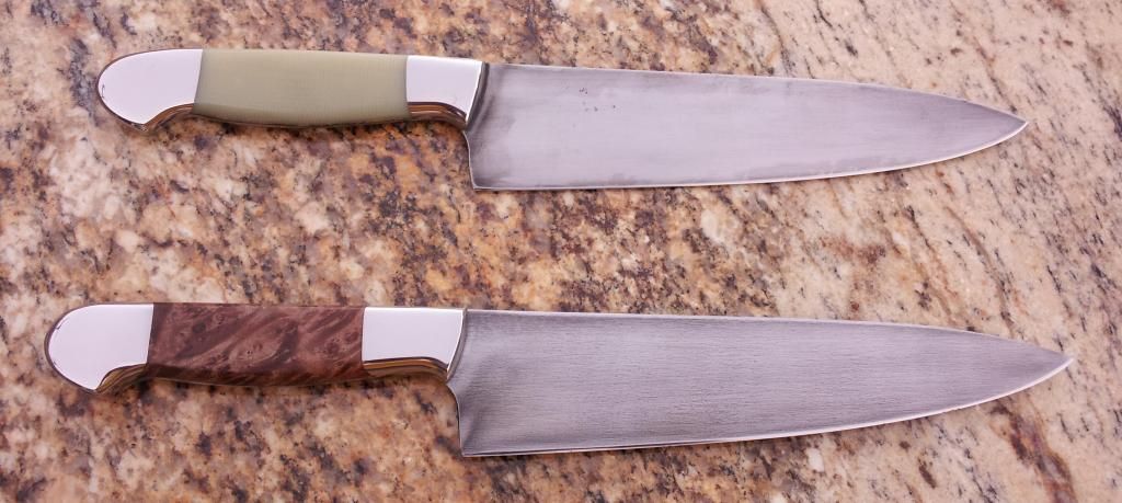

I recently finished two Chef Knives that I am very proud of...
Both of them are from 3/32 O1, Heat Treated in my digitally controlled oven, quenched in Parks 50, and tempered three times at 400 to give an HRC of 61/62
Both have a full flat grind with a convex edge on the last 1/8" of the blade down to .007, then sharpened on my paper wheels.
Both have dovetail bolsters with two peened pins per bolster and three 1/8" hidden pins in the scales, and then sealed with West Systems G-Flex epoxy.
Both have a forced patina. I couldn't get a finish I like on the Jade knife, but both are hand sanded to 600 grit.
Jade G11 Knife:
OAL: 13.3125"
Blade: 8.25"
Width: 1.875"
Hardware: 416 Stainless
Shipped Price: $250
Stabilized Maple Burl Knife:
OAL: 13.5"
Blade: 8.25"
Width: 1.875"
Shipped Price: $250
I accept Paypal at sir_j_wilder(at)hotmail.com
Thanks for looking
