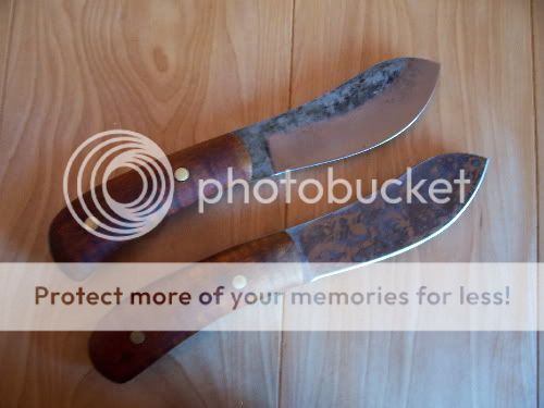

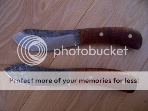

A simple and fun knife to make; this keeps my labor costs down and allows me to pass the savings along.
1/8 inch 1095 steel
Satin finish (Approximately 220 grit)
Flat ground
Mustard and gun blue finish
Stabilized maple handles
Overall length: +/- 9 inches
Blade: approximately 4 1/2 inches

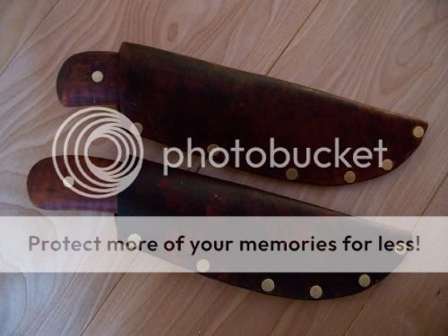

Riveted leather scabbard
Both knives are sold.
$105 each including delivery to the US and Canada. Paypal
( gldrewknives@yahoo.com ) or money order accepted.

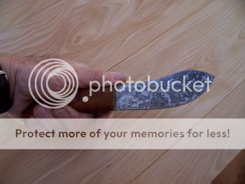

Received the knife today, and it was almost breathtaking how beautifully the sheath and the handle looked like one! Nice work, Gerry, and thanks! Only thing I'm not so sure about is the finish on the spine flat side...looks almost "dirty" or used. I'm sure it's an effect.
no, mustard like from the kitchen. The acidity darkens the steel. Same reason people will jab a blade in an apple or potato to help slow down rust.
I usually tell my customers that my 1095 knives come with a guarantee: they are going to stain. Tomatos, citrus and other high acid materials will change the color of the blade. That is the reason that I do the mustard process on most of them. It puts a controlled stain on the knife rather than waiting a few months for a natural patina to develop. If you are unhappy with the knife, please return it and I will make a refund or make one for you in stainless (at a higher cost)
