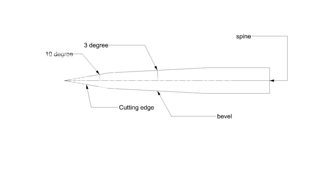

There are many grinds on a knife but the one we keep referring to is the one that makes the cutting edge of the knife. If you look at your knife you will see that there are 2 angles ground into you knife blade on each side a large slopping one and a second short one that is the cutting edge. The shorter the second one is the steeper the edge angle the lower the slicing ability, the longer it is the shallower the edge angle is the higher the slicing ability. The trade off is that a shallow edge will not stay sharp as a steep edge. I am not sure if I explained that well enough but I could draw pictures of it.
I drew up the picture any how just in case, the angles are not set in stone they are just what I used to give an idea of the different parts of the knife
You done good :p even I can understand it ;)
honestly that drawing was awesome, it just explained more about the grind than the entire spyderco sharpmaker dvd.
