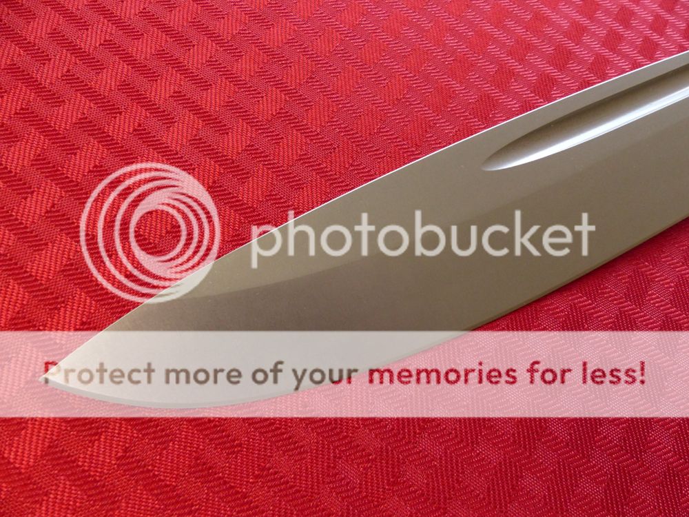

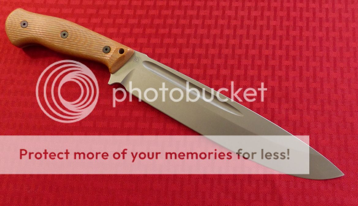

The Light Chopper was a collaboration with Lorien Arnold. It has been a long time in the making. It is an exercise in geometry, weight distribution and ergonomics to make a light weight well balanced chopper that hits well above its weight. It's a large woods knife, with a ~10" blade that weighs 17.1 oz that is somewhere between a machete and a camp knife. It's light enough to be carried on a long hike without weighing you down and it's engineered for performance when you go to use it.
It's made of CPM 3V at HRC 60.5 with the newest heat treat for 3V that I believe is the finest heat treat for this material available anywhere. The performance is phenomenal with a combination of toughness, edge durability and edge retention that will blow your mind. A lot of R&D went into developing this heat treat, it is truly different and better.
With that in mind I gave it relatively thin cutting geometry designed for cutting performance. This is not some overbuilt pry bar, it cuts like a demon, but it is very durable, see 2nd video.
It's light enough and long enough to develop tip speed to cut thinner vegetation that heavy choppers struggle with. But when you put it to work in the big stuff you'll find that it hits hard and bites deep and it won't wear you out. The grip and aspects of the cutting geometry were designed in collaboration with Dan Keffeler.

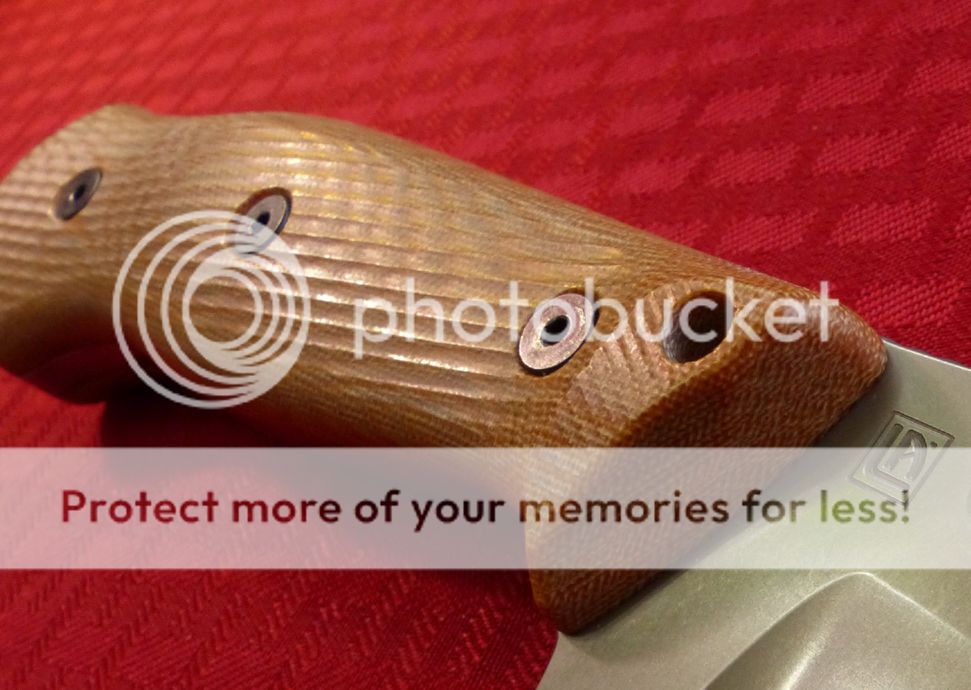

The hand grip works great as a camp knife when held towards the front with good balance and dexterity. When held towards the back it fully fills the hand and offers control and reduced hand and forearm fatigue for extended hard work.
It has a forward lanyard hole (as used in competition cuts) and a hidden rear lanyard hole.
Light Chopper Specs:
CPM 3V, 60.5 HRC, .188” thick at ricasso
Total length 15.625”
Blade length 9.875”
Edge is sharpened 20 DPS
Weight 17.1 oz
Grippy 3D machined scales in micarta
Black oxide treated 18-8 stainless steel fasteners

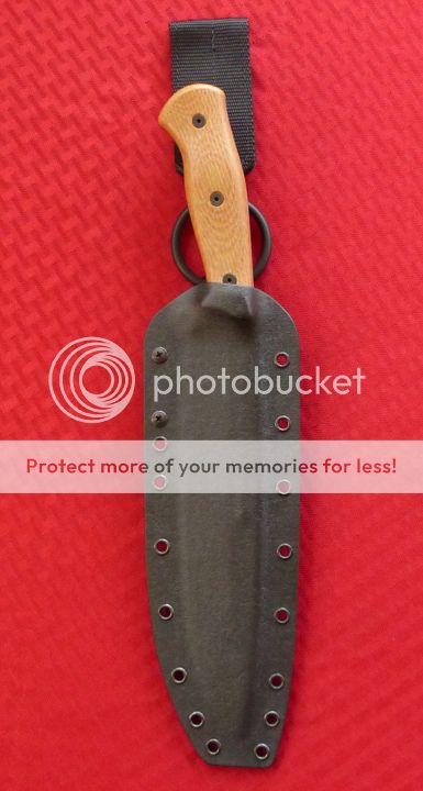

$340 without sheath, $410 with a David Brown custom Kydex sheath. There is only one sheath available at this time.

These are "field grade" with tool marks, milled and tumbled. The bevels are lightly hand ground and slightly convexed after being milled.
