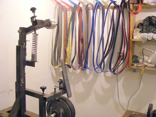

I wonder if the spring is too strong for the belt tention. What you think?
Yes I noticed that you had to really lean into it to get it to move. Hard to tell until it is mounted. Can you change the spring after it is complete?
I can trim it with a few cm. I put a bolt to limit the tention arm motion. I will see after I run the motor.

After watching your clip on the belt tracking experiment you may want to add a handle out front to make it a little easier to overcome the tensioner, while changing belts. You know the power of leverage kind of thing!

It is just clamped to the table for experiment -thats why it shakes so much. I will weld everything together, and tighten every bolt. It will be welded next weekend to a heavy steel construction, where the motor will rest. I will make a handle, that will be screwed to the tention arm for pushing down. There are many details to finish. :) Thanks for looking.

I'd add a ball to the belt change lever, so you don't accidentally put a dent in your forehead. Looks like it's close to your head.
I'd add a jam nut to the bolt you have all the lock washers on, so it will never loosen up.

Thanks, guys. I will remove this lever, and make a new lever, twisted to the left and down. My head allmost got a dent while doing testing. :D It is half of the speed on the clip - about 700 RPM. On 1400 it eats steel very fast. :jerkit: . Realy cool to work on such beast.
I made a flat platen adjustment with hardened stainless steel plate 1.4116 up to 58 rockwell. I hope it is enough hard to flat grind to begin. I mount the plate with BISON dual component epoxy. I weld an edge in the down end of a platen base, so it will keep the harden plate from falling off just in case.
Slack belt sharpening my field hatchet. 100 grit norton zirc belt. I have now 36, 60 ceramic nortons, and noraxes from coars to extra fine grits. Fully armed grinder. :jerkit:
