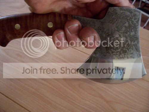

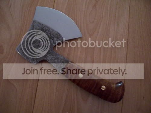

My wife and I are headed for Alaska next summer for 6 weeks of camping and kayaking. I have given a lot of thought to my gear and just completed this little ax to take along. It is small enough to fit in my pack but will still cut firewood; small of course. I figure to use it like an ulu for cooking and use it as a combination knife and ax. It will be almost impossible to peel a potato but I will be taking my leatherman along too. When I lived it the Great White North one of my fishing guide friends used to show off by using a small ax to filet walleyes. Lots of possiblilties here.
What do you guys think?
I love it!:thumbup:
I like the rough to polished look, very cool.:cool:
Nice wood as well.
I think we should all get one!:D
I like it, clean lines, aesthetically pleasing. How's the balance?Weight? Material? Got some pants to protect it from the elements? I can definitely see the versatility of it in the right hands. I might have gone a bit bigger personally, for leverage since I'm not a big guy, but if you're comfortable with it I say she looks great.
Gautier
Fantastic! That looks to be a very usefull tool. :)

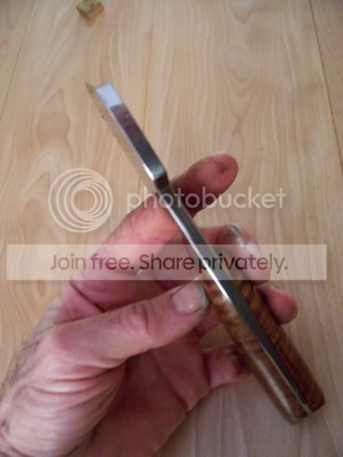

Any chance of a shot of the spine? Whats the steel?
Thanks,
Matt
That's really nice, I like it. BTW in case you haven't noticed, you do great work!
Besides that beautiful axe, I would bring an H.I. chiruwa angkola khukuri, I lived and guided in alaska. Have a great trip.
Thanks for the comments and kind words.
The steel is 1/4 inch 1095: I just about wore out a hack saw blade cutting this thing out. I heat treated it a little softer than I would a knife just because I want the ease of sharpening in the field. (My leatherman has a diamond sharpener.) I also hope to try it out this week because I anticipate having a deer to skin. I think the sweep of the blade will work perfectly for skinning. I don't know if you can tell but I tapered the tang on this to cut more weight and make it balance heavy to the head.
