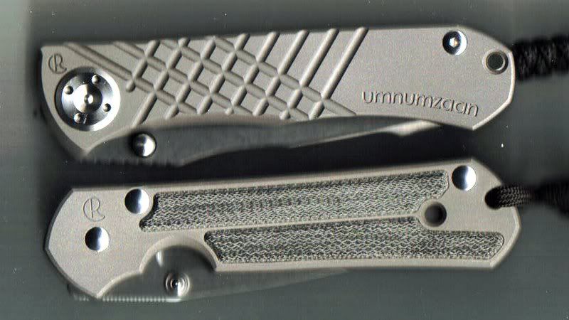

Possible. I'll let you know tomorrow as mine will be here. Notice how there is a ridge in the bushing of the Umnumzaan and a place in the handle slab for it to sit. Not a feature on the Sebenza. Maybe this disallows for overtightening? Just a different principle then the Sebenza.

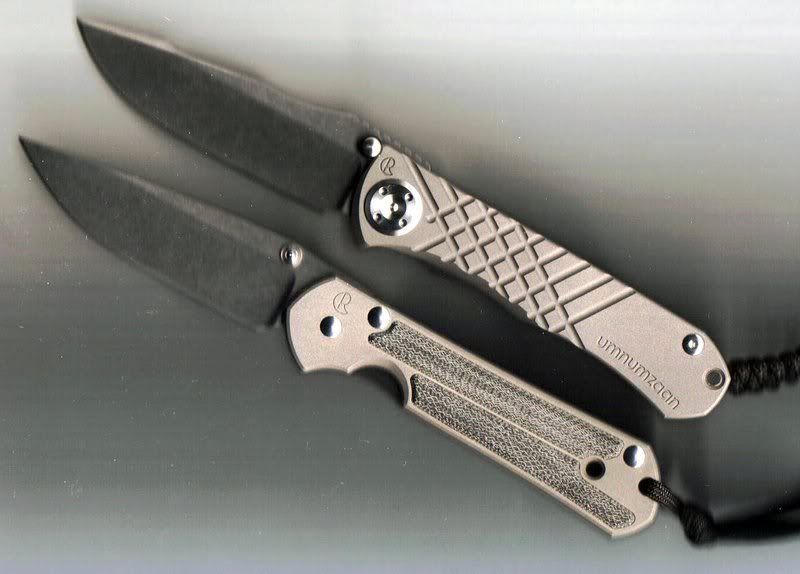

Well.......Umnumzaan in hand, and all I can say is WOW! Very cool! The knife fits my medium size hand like a glove. Ergonomically the handle shape far exceeds the Sebenza(sorry, you guys know I'm a Sebbie freak). The bottom of handle is perfect for your four fingers. My index finger sits between the front groove of the handle and the lock release. Middle finger just between the back(or bottom)of the lock and the first curve(wedge). The last two fingers snuggly behind the wedge and the back of the frame with about a 3/32" frame left. Sounds like I'm describing holding any knife, but my point is that your(my) hand automatically finds the sweet spot on this one. The large Classic kind of does this but not nearly as nice!
Next...The length is pretty much the exact same size as the large Classic. The difference being the blades. This part is pretty cool. The Umnumzaan blade length overall is actually shorter than the Classic, but the cutting edge(numzaan) is longer. Huh, you say? Without the need for a inner stop pin, less blade goes into the handle. I'm going to try and get some picture up soon. I don't have a digital camera at the moment, but I'll figure something out.

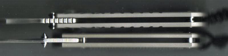

Hard to tell but I'd say the titanium handles are the same thickness as the large Sebs. Maybe a tad, and I mean tad thicker. The blade is about 1/32" thicker though. Nice. I really like the swedge and it is almost sharp. I cut into a thick piece of paper, and it tore more than cut, but you could put a scary sharp edge on it if you desired. The lanyard ring is neat, as there is hole in it where your lanyard goes through.
The lock. Interesting......There are three(3) detent balls. One holds the knife closed and also prevents the lock from overtravel. One is on top of the lock(new and kind of scary to me). Guessing the ceramic between the titanium and blade helps with lock up. It definatly prevents sticking which I've heard many here complain about. Very soild lock up though. The third ball is a huge one right behind the upper lock to prevent backwards over travel upon closing. A very nice touch.

Wish I could, I'll try. I took the photos with my scanner and it was hard enough get the pix that I did.
On another note, talking with Heather today, I found that the blade thickness on the Sebenza is .121 and the Numzaan is .150. The titanium handle slabs are the same size!
Great pics Blackend!:thumbup: I can't imagine that the tightness of the pivot will bind the motion of the blade. IMO that would be a step backwards for CRK and I just can't see that happenning. Chris takes his knives too seriously to leave out something like that. That sharpenend swedge is something else, isn't it?:thumbup::thumbup::cool::D
Also you can go with/without the lanyard without untying it. Very:cool:!
