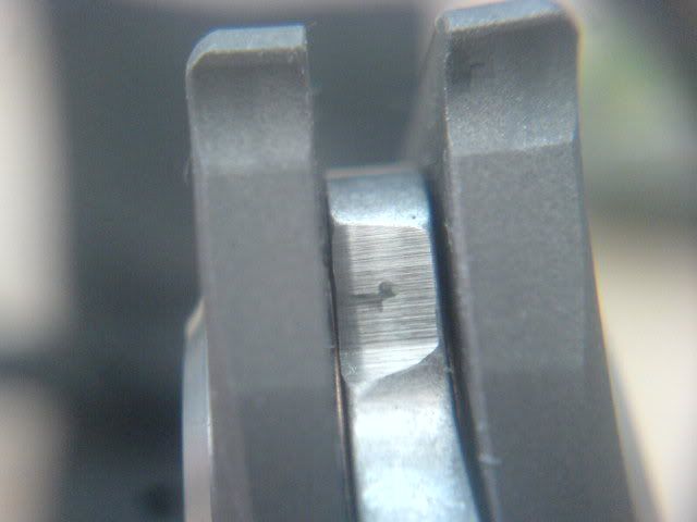

On two photos following this sentence, You can see marks on tang left by the ceramic ball, so there should be no more doubts.
Another thing that I'm curious about, as I keep thinking about this, is how the tang got so dented by the ceramic ball. The tang appears to be a lot softer than the ceramic ball?
Well ceramic IS harder then the steel. Steel tends to deform. Ceramic is so hard it will either shatter or crack if to much force is applied. This is actually a worry that I've had about having a ceramic ball in the locking mechanism. That under extreme force it would crack or break. Guess that won't happen :o I would assume that the tang is hardened. I hadn't really thought that deformation to that degree would occur.
Looking at that picture more however I would have thought that as the steel deformed it would be smoother then it looks. In other words, one smooth depression. Could it be possible that in the mud grit and or a tiny rock caused that damage? Or that part of the ceramic ball chipped and gouged that out?

I just checked a couple of my user Zaans and they both have wear on the lock face of the blade....one is substantial (IMO)...looks very similar to the pics above...lock up is still fine with no blade play.
I ain't trippin but i was surprised to see it....i'm gonna play this one out over time and see what happens. :)
maybe these dents did not form in the test?
a firend of mine handled two Umnumzan's, one of them came from the first or second batch. it was brand new, but it had dents like this.
if (only if) these dents were caused by the force, then I have to say that maybe using the ceramic ball was not a good idea.:confused:
the wear on the lock face of the blade came from CRK, my friend told me that the wear made it easier to open the knife;
newborn Umnumzan's have similar but less wear.

Mine is very new and also has similar wear. Regardless, I have no intention of getting rid of mine based on this test, nor do I have any fear that mine would fail in a spine whack test. Despite not knowing the exact cause for this particular knife failing a spine whack test, I do feel that a spine whack test failure is more the exception than the rule. In any event, one knife of a mass-produced model does not and cannot provide a statistically significant result (regardless of whatever that result may be).
cannot agree you more. it is still unknown what caused these dents. so let's wait for the answer.:D

Thaks for the pics. They really have a lot to say about all of this. It seems to just keep getting more interesting :)
So bgmark you say that yours has the (for lack of a better word) "gouging" like the one in the user test from poland?
xzhang's picture is what I'd expect to see. I mean a ceramic ball is certainly going to mark and lightly smooth the lock face some. I was just surprised at the amount of deformation that the other picture seemed to have.
With that said I'm far from any kind of expert on metallurgy and I trust CRK pretty implicitly so I'm not saying this is bad I'm just a little surprised.

No offense taken at all. If there is a hardness difference, or maybe even if there isn't, it does seem logical that there would be some kind of marking on the tang, if only due to the difference in the size of the contact area? A normal RIL lockbar could have a lot more surface area engaged on the tang than the Umnumzaan system with its small ceramic contact point?
I have a Umnumzaan and it was purchased in Jun 08. The tang on my Umnumzaan shows a very light, lateral mark where the ceramic ball has made contact with the tang (similar to xzhang’s picture), as a result of the lock engaging and disengaging the tang. I expected this when purchasing the knife, knowing the ceramic ball being harder than the tang material.
I would be curious to know when the deep galling was first noticed. If we follow the sequence of the vids and pictures, it would appear it developed during kamilpoi’s exercise in stabbing the refrigerator, keeping in mind he’s introduced numerous shock loads. Pushing the blade forward, to remove the knife from the refrigerator, is also another key factor. Where is the bearing surface or critical area during each stabbing and blade removal? Tang and ceramic ball. The primary task of a knife is for cutting. Anytime a shock load (as in this case, all steps involved in the repeated stabbing to the refrigerator and removing the blade from the object) is applied, the probably of damage or malfunction increases.
The galling shown on kamilpoi’s tang is severe. It runs lateral, but also tapers downward. It doesn’t surprise me a light “spine whack” caused the lock to disengage. Simply, the ceramic ball has minimal to no bearing surface on the tang and follows the galling when minimal force to the spine is applied.
