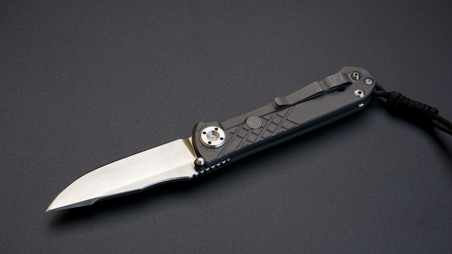

Umnumzaan disassembling
Great pics man :thumbup: I need a good camera, maybe I should stop spending all my $ on knives and sharpening equipment :confused:

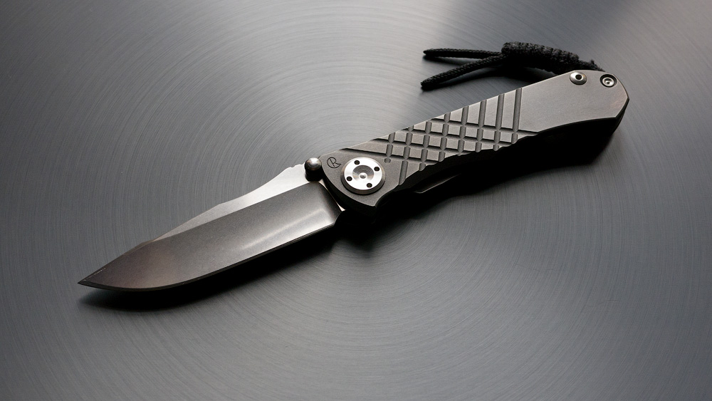

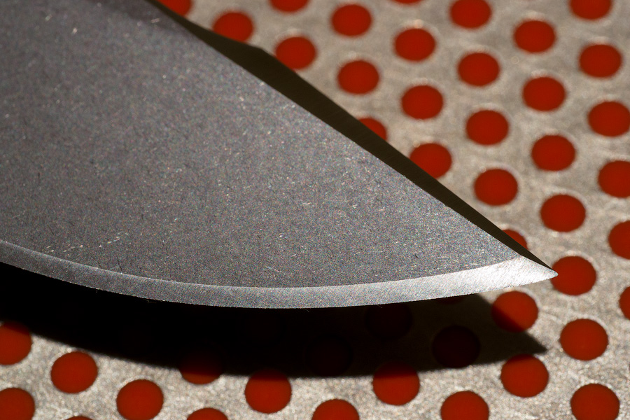

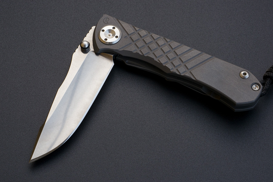

Some photos about sharpening my Umnumzaan.
I used DMT Diamond stones 8" and Spyderco Triangle Sharpmaker as guides.

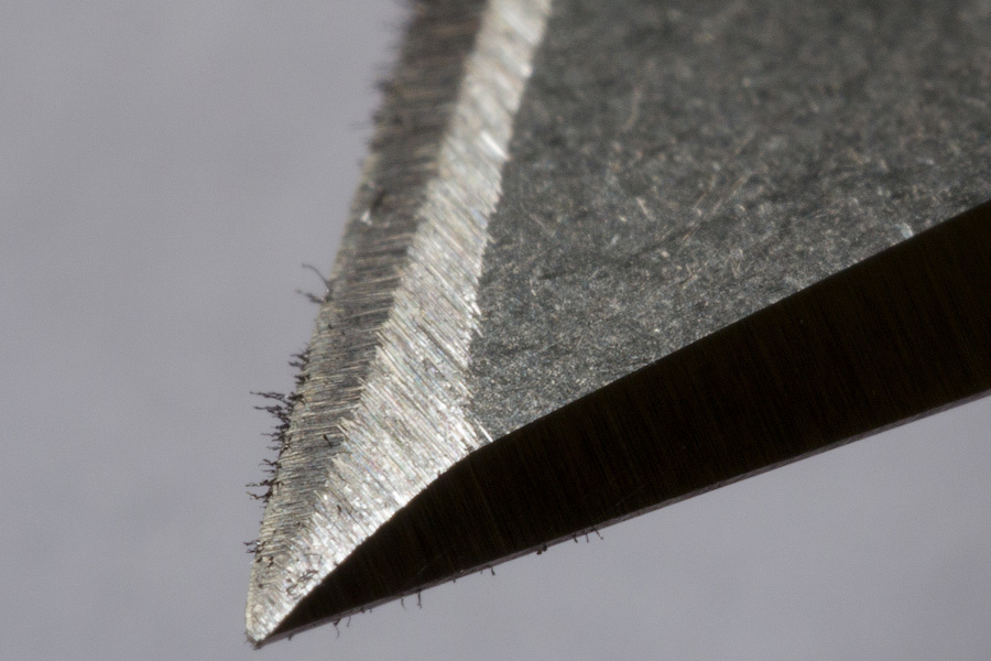

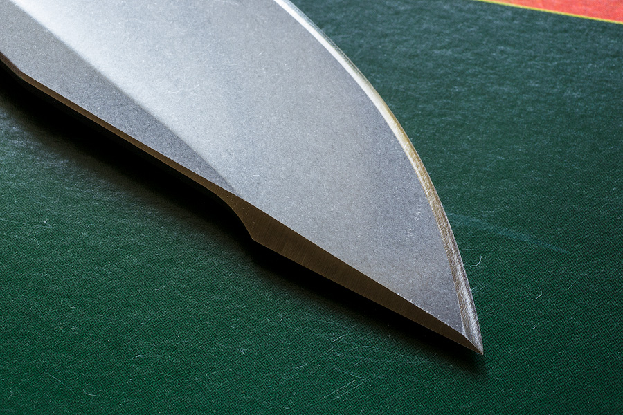

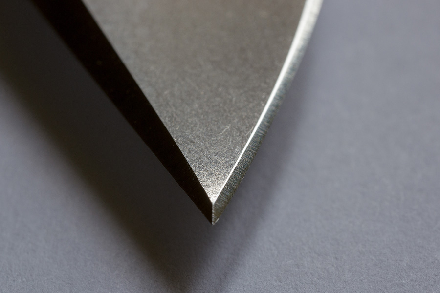

Edge before sharpening:

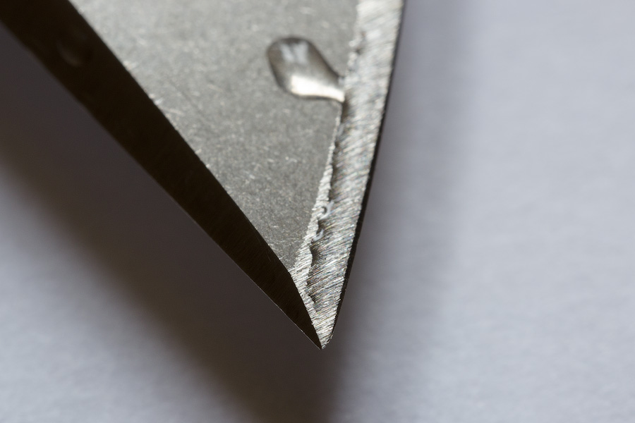

At first, DMT Extra Coarse at angle of 30 degrees:
[video=youtube_share;XOZ36y6vCXM]http://youtu.be/XOZ36y6vCXM[/video]
The burr appears.

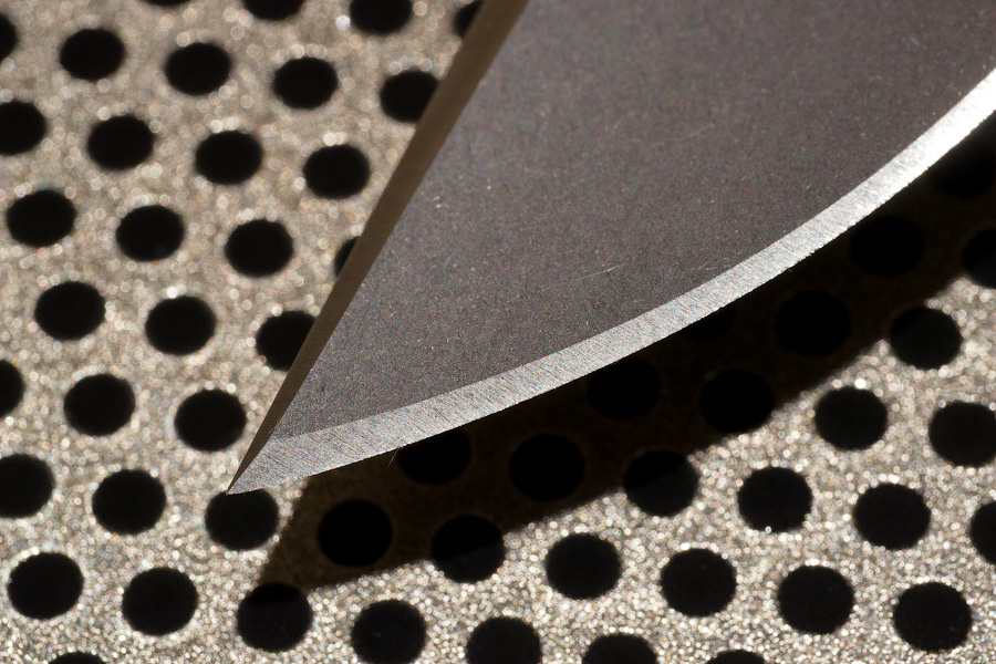

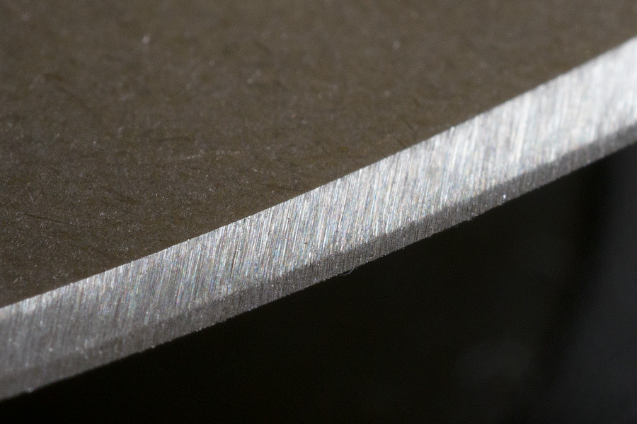

20 minutes later, after Extra Coarse:

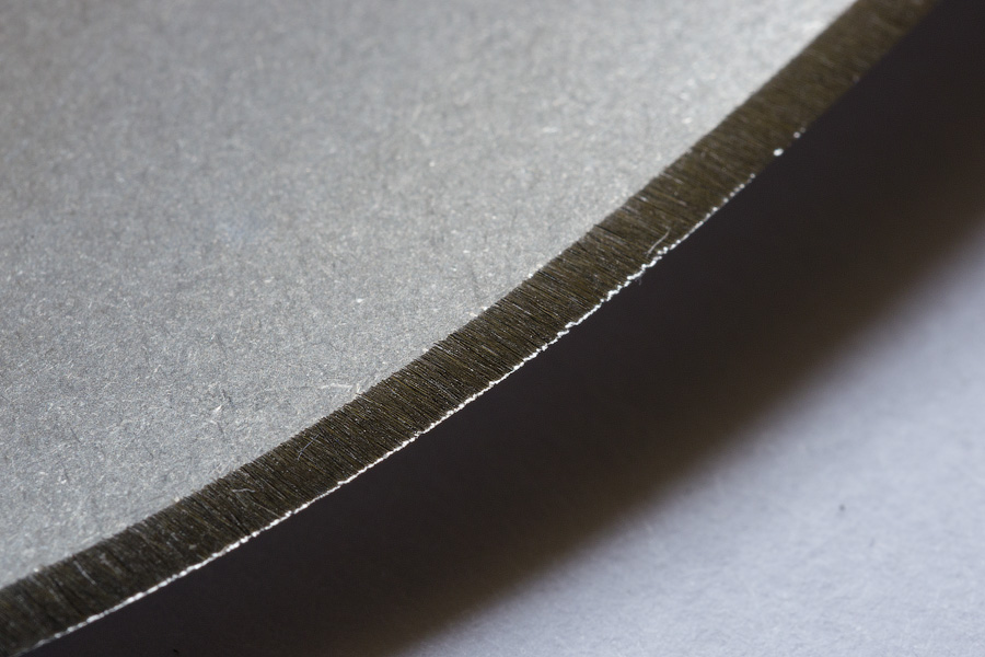

Next stone is DMT Fine (red) at 30 degrees.

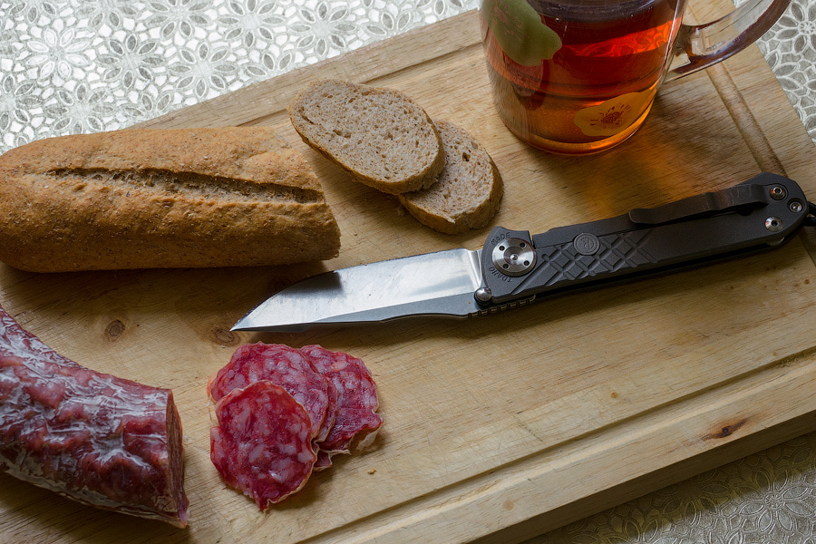

Next, I do small 40-degrees edge. About 15 moves from each side. Now the knife able to cut. Not perfect, but quite easy.
Next, DMT Extra fine 6" at both 30 and 40 degrees. Now, the knife is sharp.

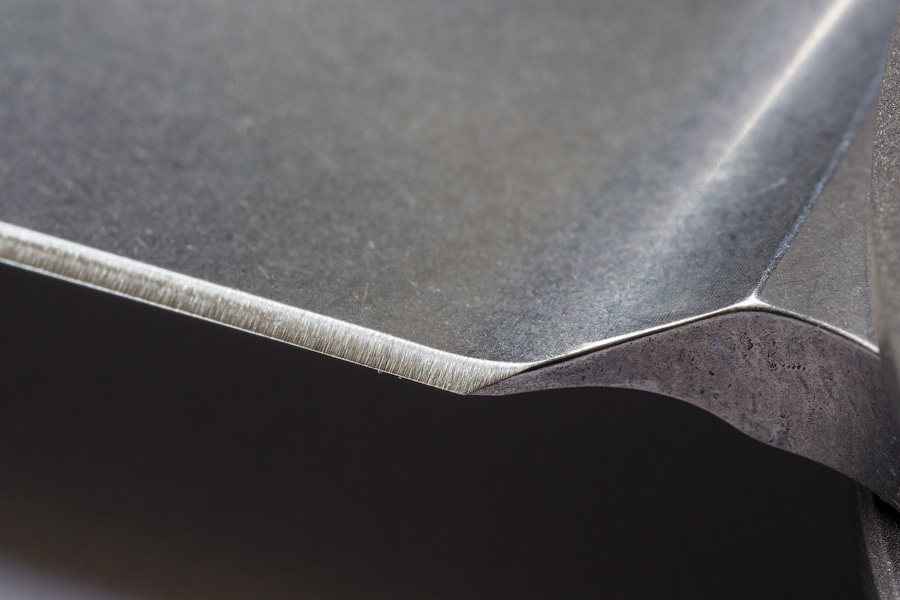

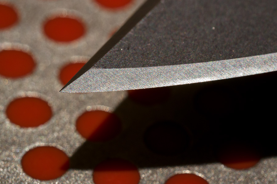

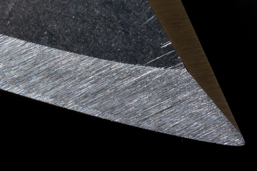

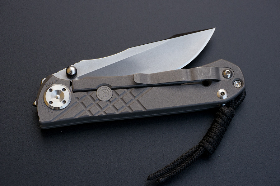

But we have burr yet, so next step is Spyderco Triangle Sharpmaker's ceramic stones (only flat surfaces).
- at first, grey Medium
- then white Fine
- finally, white UltraFine with red ends...
Now the Umnumzaan is very sharp. Easy shaving etc.

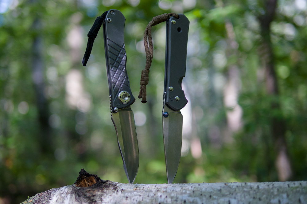

Finally, Assam tea, bread and Casademont dry-cured sausage. Good wishes :)

I have one question tho, does the Umnumzaan come with a sharpened swedge or is it a false edge?
Swedge is not real sharp edge, it do not cut paper, wood etc.
But you can cut steak or burger, for example.
I was just bit worried that you might cut yourself if the swedge was sharp since it stays unprotected when knife is closed.
