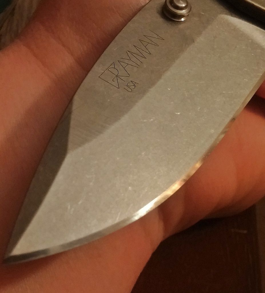

So I put my Grayman Dua on my edge pro last night. It was the first time I'd sharpened it so I wanted to regrind the levels to a more usable angle. I set the sharpening rod at 22 degrees and got to work with the factory 120 grit stone. The factory was pretty uneven and took me awhile to raise a consistent burr but when I flipped the blade over to work on the other side, no matter how hard I tried I couldn't get the bevels to match width. What am I doing wrong? I held the blade in the same position relative to the sharpening table on both sides and never changed angles so why is one side bevel wider than the other?
Not the best pictures but you can clearly tell one bevel is wider than the other. All advice is welcome. Thanks for your help

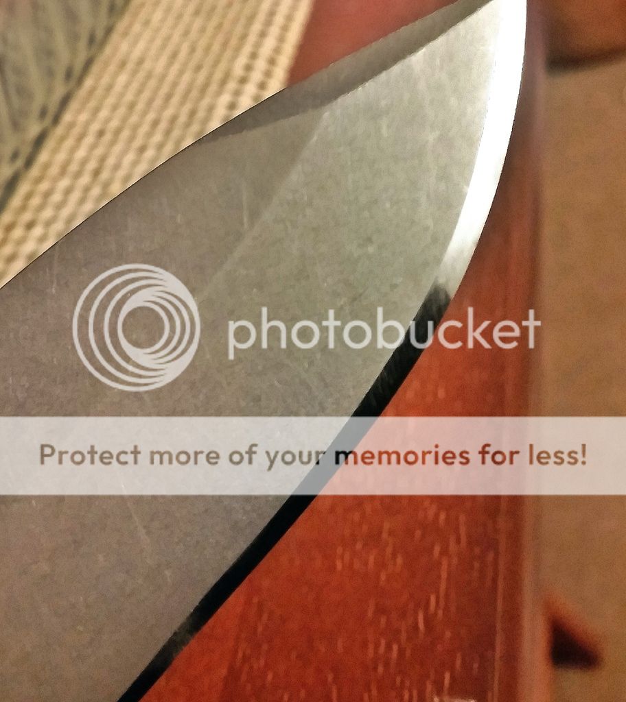

One side of the knife could be thicker than the other. The primary grind, not the bevel.
Did you grind one side completely then switch?
It's always best to grind a little on each side until a burr forms. Grinding one side completely down before switching to the other side can have many bad results. To me, it looks like your edge is asymmeteric from grinding one side too much.
You will want to inspect the centering of the edge bevel with the full thickness of the blade at the heel. The edge apex should be the centerline of the knife.
Next, you will check the centering of the tip by looking down at the edge. This will give you a good idea of bevel symmetry. In this picture the edge is facing the camera like the last picture.
To me the edge looks pretty centered. I tried to flip periodically so I didn't grind too much on one side. Although, the side with the wider bevel took considerably longer to reach the apex than the other side. When I put it on the sharpmaker before this one side hit the whole edge but the other side was only hitting the shoulder. Is it possible the edge was just off center out of the box?
I'm not too worried about since this is a hard user and it's still shaving sharp, just the aesthetics bother me.

I measured the edge This morning and it's pretty centered. Its literally, about the width of 2 hairs, biased towards the side with the skinnier bevel.
Its just the looks that bother me, it cuts like a laser.
Looks like the primary grind on the presentation side is shallower (lower angle). Measure down from the spine to start of primary grind on both side and compare. If one side is shorter, then that side is shallower and will display sharpening results you have illustrated, other things being equal (example: you have not ground one side of secondary more than the other - secondary is centered with cutting edge).
If primary or secondary bevels are not even, you'll get what you see when sharpening on fixed angle system. Also, this can happen if you "accidentally" sharpen one side with flat on table and other with primary on table :-/
Edit: I always inspect & test grind each side of a fresh knife to understand how each side of the knife matches up, and then make a "plan" for how that knife will be sharpened. Knives that have uneven primary bevels always need special consideration. My primary daily carry (which has dead even primary bevels), I am currently asymmetrical (differing left/right) secondaries because I like the way the combination feathers wood and slightly steeped side gives a little added strength to cutting edge, while still allowing low approach angle of the left side when right-hand cutting. "Even" bevels (in my mind) are purely aesthetics, not really performance related.
Can you measure using calipers from the knife edge at a reference point to the spine edge on one side and compare that to the measurement from the same reference point to the spine edge on the other side opposite from the first measurement? This will tell you if the knife edge is centered on the spine, at least. If the distances are not equal, then this would help explain why your bevels are not equal, assuming symmetrical blade design.
You should be able to continue grinding down at the same angle on the side where the bevel is short until the bevels are even. The bevels will get even as you keep grinding metal off the edge until the bevels equal the same measurement. Of course, if the edge was centered to begin with with the bevels uneven, then the edge will be off centered from the spine's centerline but your bevels will be even.

Some knives are just made off center. Happens during the manufacturing process. When you use a sharpening device that is consistent then this shows up. Not too common.
Your not doing anything wrong.
Nearly every Ontario knife I own has come this way. (and I own more than 10)
The primary bevels were not ground the same on both sides which will move the apex when its sharpened on a fixed angle system.
