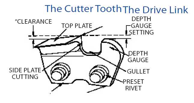

If you look at a chainsaw tooth, you'll note that the chisel is oriented such that the flat-bevel (back) is oriented with a 10-15 degrees clearance angle to keep it off the surface of the medium and give it a specific depth of penetration regulated by the forward gauge. The clearance angle is a necessity.
While the depth is controlled by the front guide tooth, one can buy a more aggressive chain if the motor has the power to pull it, in NJ when cutting pine, we will often go with an Oregon co. chain due to the more aggressive cut in softer wood compared to a chisel ground Stihl co.
See the following for chainsaw tooth type info:
three basic configurations exist. Full chisel chain has a square cornered tooth, splitting wood fibers easily in the cut for fast, efficient cutting in clean softwood. Semi-chisel chain has a rounded working corner formed by a radius between the top and side plates. While slower than full chisel in softwood, it retains an acceptable cutting sharpness longer, making it the preferred choice for dirtier wood, hard or dry wood, frozen wood or stump work, all of which would rapidly degrade full chisel chain. "Chamfer chisel" chains by Oregon are similar to semi-chisel design but have a small 45 degree chamfer between the plates rather than a radius. Performance is similar to good semi-chisel.
With all of that being said, while the angle of the flat edge would only be important in so far as the amount of steel reinforcing the edge, considering that the effect it has on the depth of the cut is negligible although it does have some.
fwiw: The type you are referring to is the chisel ground.
