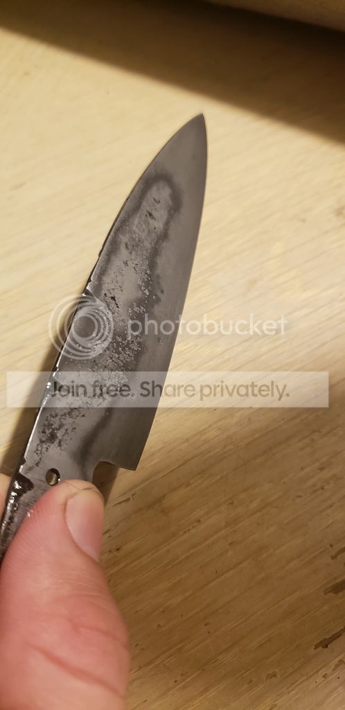

Unintentional 1095 hamon??

I'd say you have a hamon, bring it out. Get some flitz polish and 1500 grit polishing powder. There is a wonderful tutorial on how a member here makes a hamon. Sand, Etch( 1 part acid , 4/5 parts distilled water, polish with flitz) (the green stuff, it removes oxides very efficiently). I use a paper towel or felt for polishing

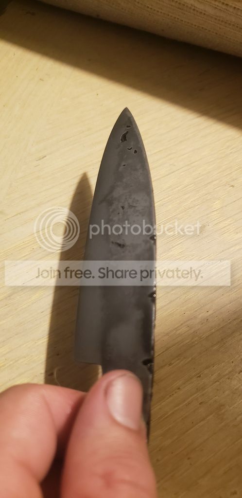

Thanks Kali4nia! So heres what i achieved with only using 3:1 Water to FC, neutralizing in windex, and polishing with mothers mag and aluminum polish using make up removal 100% cotton round pads.
For some reason the one side didnt develop a definitive hamon line, im sure its something I mustve done wrong. But the other side seemed to develop a nice dark line.
