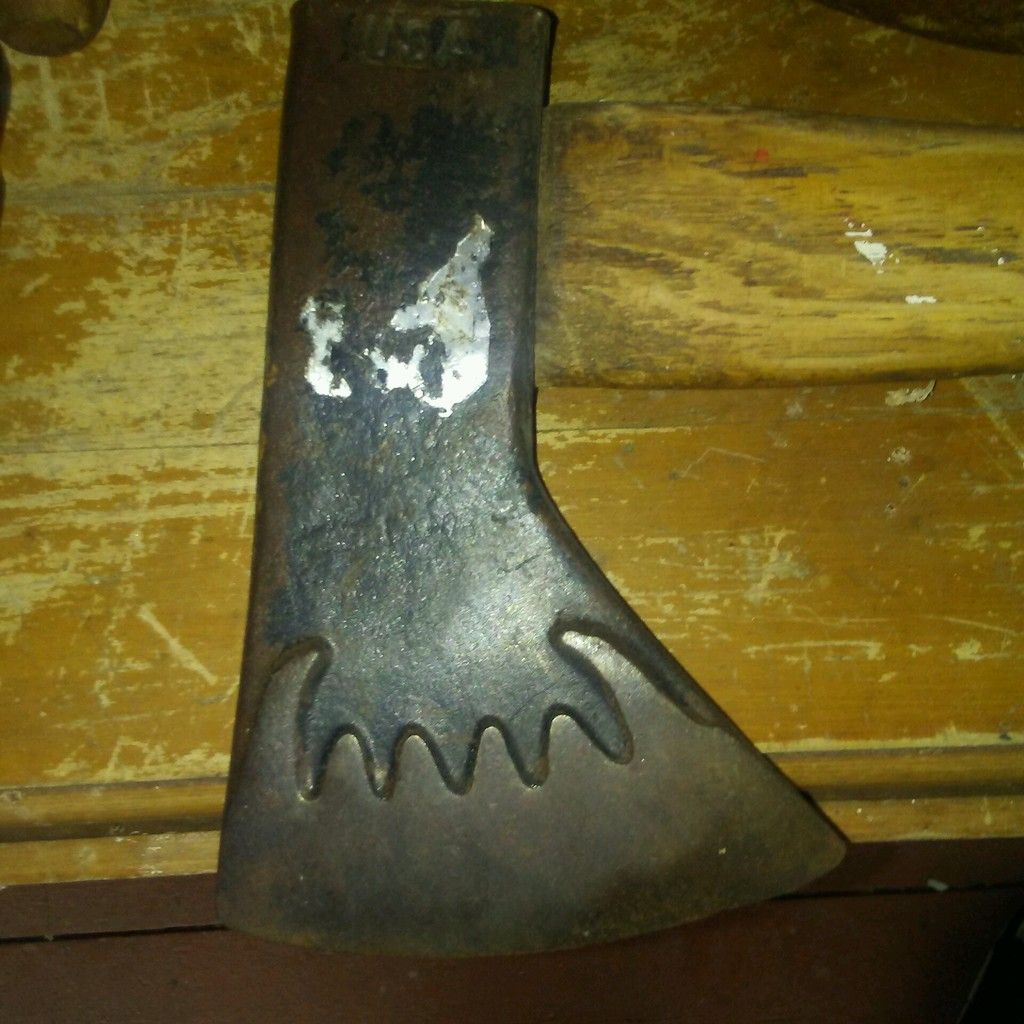

I have a like new, with paint Council FSS boy's axe I refuse to hang because it has a "dent" in the edge instead of a chip.
Yep, a Hudson bay with teeth and fangs. I would imagine they still have the dies for those. They could make a killing on those if they brought them back.
Can't make an axe with a good old fashion high center line or a decent heat treat but fangs and nonsense is no problem.
Excuse the rant, but it happens every time some one posts one of those.

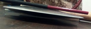

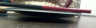

No high center line on this one either. Its not a new axe but its not very old. Maybe things have changed?
Its a 4lb dayton.
