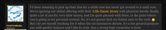

That's certainly not a strong high centerline but it's clearly not flat either. Flat means flat, yeah? ;)
It sounds good but axes are made from relatively simple steels. Your theory doesn't hold water in actual practice. Show me a axe that will roll an edge and I will show you one that won't hold an edge and takes damage to easily.
My dubious statement about high center lines no longer warrants further discussion...

I agree. And a minimal convexity combined with properly done bevels and bit will work quite well. I am thinking Kelly perfect on this statement. But this ain't it.
My personal Classic Jersey. I've not done any work to the cheeks to enhance the high centerline--this is how it was from the factory. All I did was thin the edge and blend it in.
Measured directly at the line running between the heel and toe of the bit there's about a full 1/8" of altitude from the edges of the cheeks. For a modern axe that's pretty decent, and while far from the most extreme of vintage examples, it's also far from the flattest.
Check that council farther back on the cheeks , My 1950's Collins homestead Michigan is similar at the bit ( maybe a little better ) but is much higher down the cheeks.
This when I had it hung and was using it kept it for being too thick at the bit but still have enough convex to help during splitting.
Now the next question...does the El Lobo have a high centerline, too? I'm genuinely curious.
That is a good question. I'd be surprised if it did, though. Pretty sure these were really more of a marketing gimmick than anything else, and from what I've heard they actually didn't even sell well enough at the time to recoup the tooling cost. :p

It's actually flatter near the bevels. I was being nice when I snapped they photo closer to the bit.
I see in no way how that could fit the description "strong high centerline". High centerline is technically correct.
Me two. At the fact that people who know better do not have the intestinal fortitude to call people out who claim that a bit heavy Jersey with an 1/8th of daylight at the corners of the bit an ax with "perfect balance" and a "strong high centerline".
