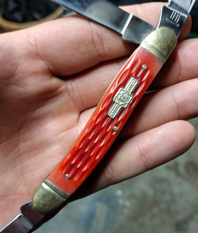

Well, I chucked the redbone Rough Ryder stockman into peroxide about 11ish last night. This morning it didn't look any different but the liquid had a pink hue. I left it in there, so we shall see what it looks like after work.

I had the redbone Rough Ryder in the 3% solution for about 24 hours and it barely did anything. The liquid had a pink hue and you could tell some spots were a bit lighter, but overall it was a fail.
After this photo was taken I hit it with black leather dye for two 15 minutes soaks and it didn't take very well either. It did give it a sort of darker dirty red look though.
