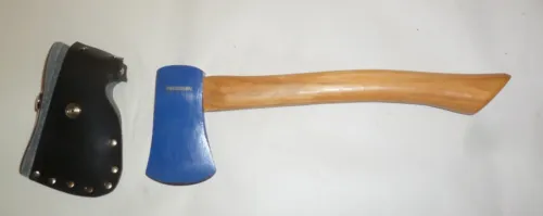

when I ordered my 1st 10 years ago it came with a black faux leather belt sheath that I no longer have.
They were still available back in 2019 when I ordered my last 2, but they weren't including them at the time.
Btw can you imagine if they were still doing them like this ?
