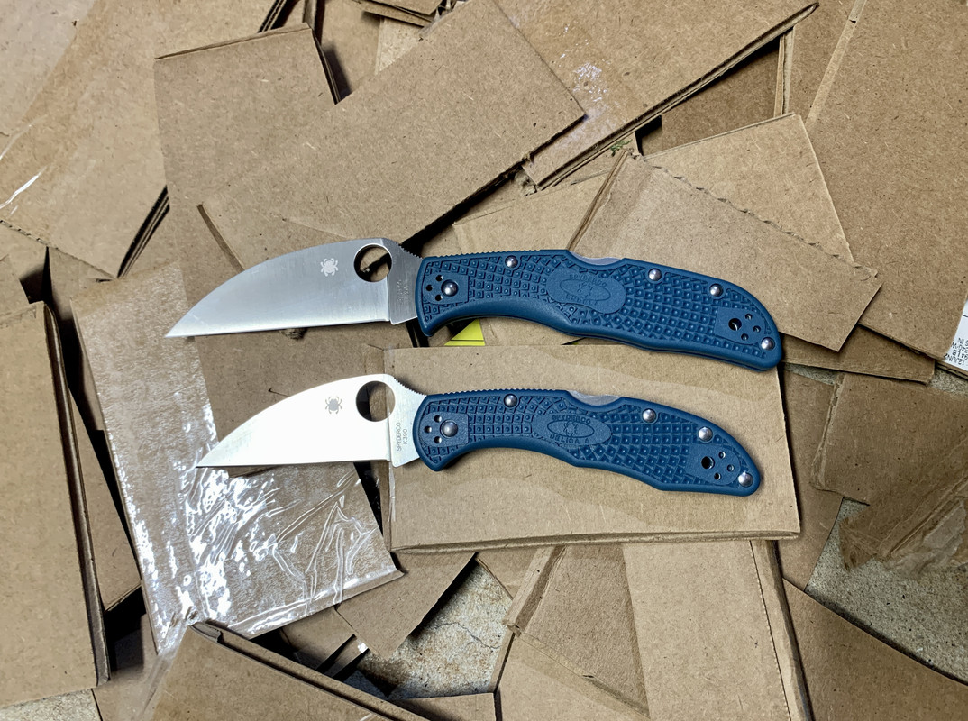

In my experience I lose the hair-shaving sharpness relatively quickly, but it continues to cut cardboard for a looong time after that. For instance, I've been using a K390 Endela wharncliffe to cut boxes for home recycling for over a year. I can go 2-3 months between sharpenings before it stops gliding smoothly through cardboard. No stropping in that time. I run a 17 dps edge with a 20 dps DMT Fine (600 grit) micro bevel, which is quite obtuse!
K390 is the best performer on cardboard so far in my experience. The stuff is magical.
