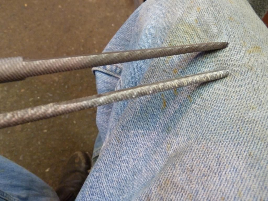

Any chance we could see more of your mad photobucket skills and get a picture of your modified round file you used on the ivory?
yes I could do that but I am about to head off to install a railing so it will need to be later today but I will show some stuff from the file

Thanks again everyone. Bill I am looking forward to having you in the shop again. Mark thanks for the kind words, this project has been a lot of fun, now that I have read back over my post and there is at least one or two oops's, I will do better next time. Now for a shot of those files

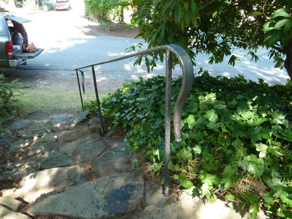

and ya it is not all fun and knives sometimes I am out putting in the blacksmith stuff
I do not do as much as I use to but i enjoy a fun job like this one from time to time.

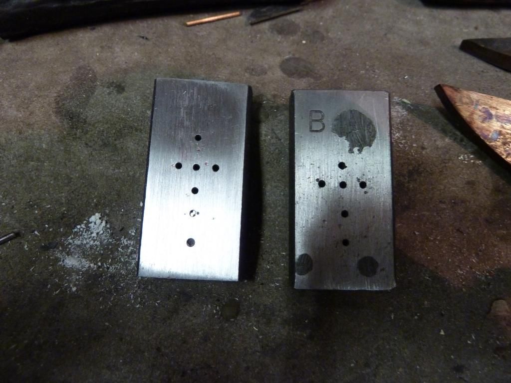

here are those index blocks I want to make sure if you use them you get what I was saying about flipping them
so you see how I have marks like the B on one of them that lets me know when I am drilling that this side needs to go to the butt cap so the other side goes to the ivory or stag or wood, you get it. Thanks again to all who joined in.

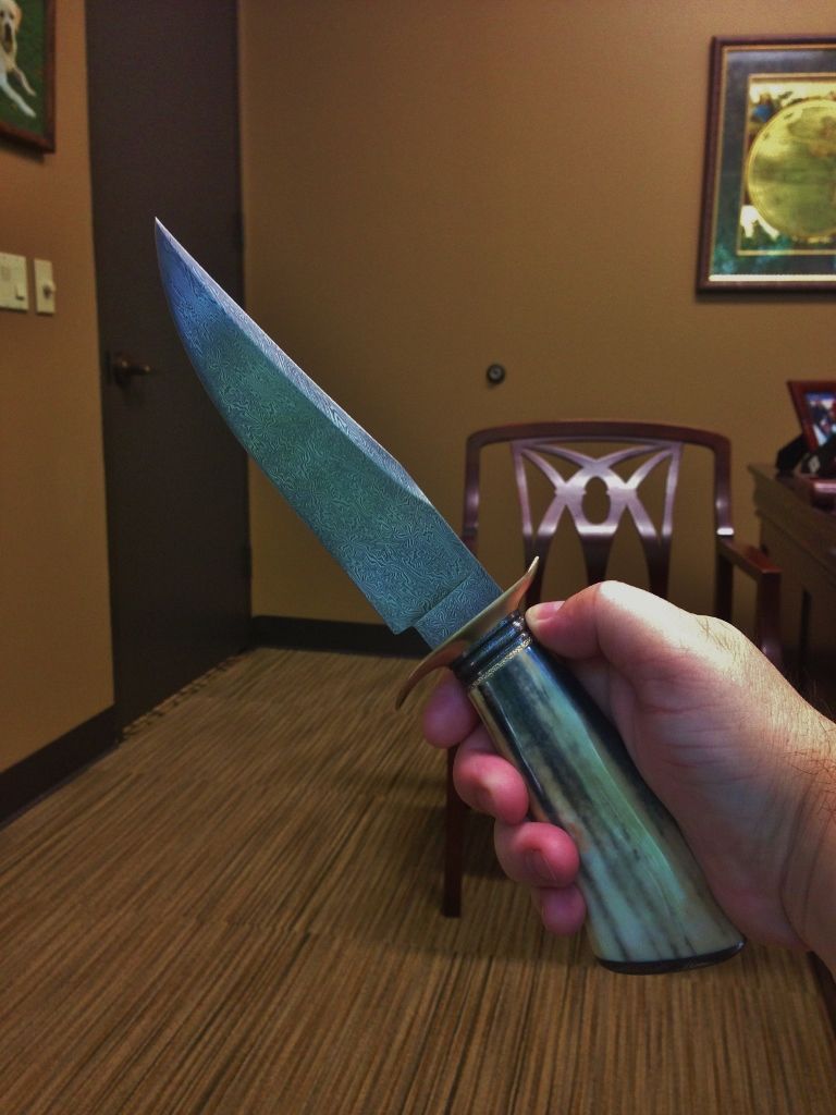

I lucked out. By the time I told Dave to ship directly to Paul Long to was too late. He had already dropped it off addressed to me. So, I did get to see and hold it, if only briefly, before sending it off to Paul for the sheath. It's even nicer in person than in Dave (or my) photos.
Congratulations Mark, you've got yourself one beautiful knife there.
Dave, great WIP showing some rock solid construction techniques. I've got a whole mess of safe edge files but none like those. Time to build some along with the butt plate drill guides. Fantastic work my friend.
