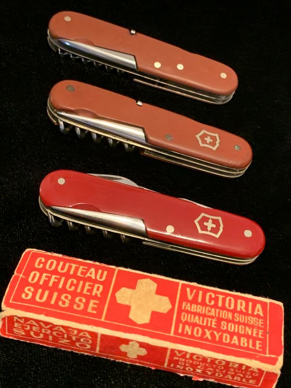

I know I'm supposed to figure it out from the pic, but I didn't. So what's wrong with it? Discoloration?
It’s the flatness, and lack of it near the center pins. Sunlight across the surface to show the deep spots in the shadowed areas. Parts that are poorly finished and left on the sanding drum too long.

Just a quick comparison pic…
EDIT:
Sorry guys…must not have hit the button to actually edit this post earlier with a description.
Top:
2nd copy, serial 2,2xx range. Better, but not perfect finish.
Middle:
1st copy, serial 1,5xx. Modified scale finish — rounded edges and smoothed original sanding marks and deep spots (mostly). Also removed a bit from the can opener stud since this pic was taken. It protruded too much from the scale surface (which was too thin already compared to the originals which were close to flush)
Bottom:
c. 1930 Model 205

This is on my modified replica:
rivets polished like I think Victorinox should’ve done

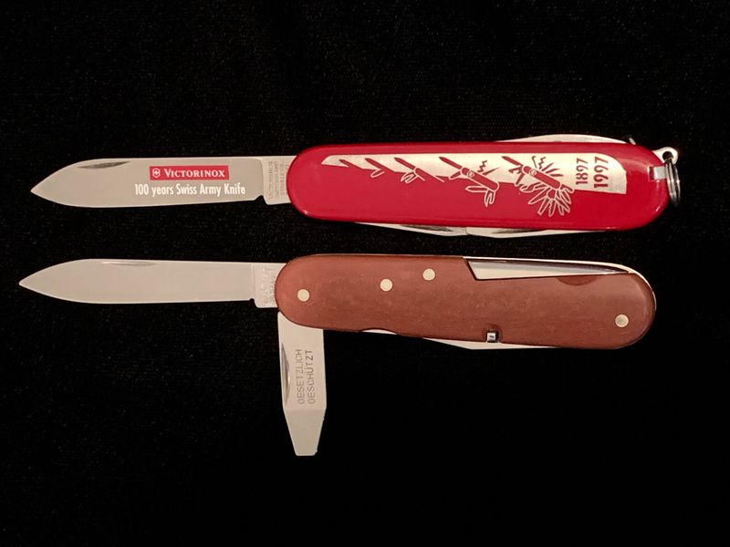

After doing a bit more research and investigation I had to change my view a bit on the ’correctness’ of some items:
It does appear that carbon steel was used for the pen blade spacer in early knives. So the use of the stainless spacer is better than a nickel silver one. It still does stick out too much as I felt earlier.
While most collectors agree that the pen blade profile is too deep, many thought the main blade was too narrow. After seeing an early carbon steel blade that was unsharpened and very close to original, I think it could have been even narrower and both could’ve been finished/sharpened with a smaller bevel.
The cylindrical barrel shaping of the scales is more correct than I thought. It was not until later that fiber scales were finished flatter like my 1930s knife.
I’m still not a fan of the sharp perimeter edge transition on the perimeter of the scales, but it certainly doesn’t bother me as much now.
I wish it were possible to get raw stampings from Victorinox and I could make one that had tools finished like the originals with sharp edges and corners on all the tools and backsprings.
