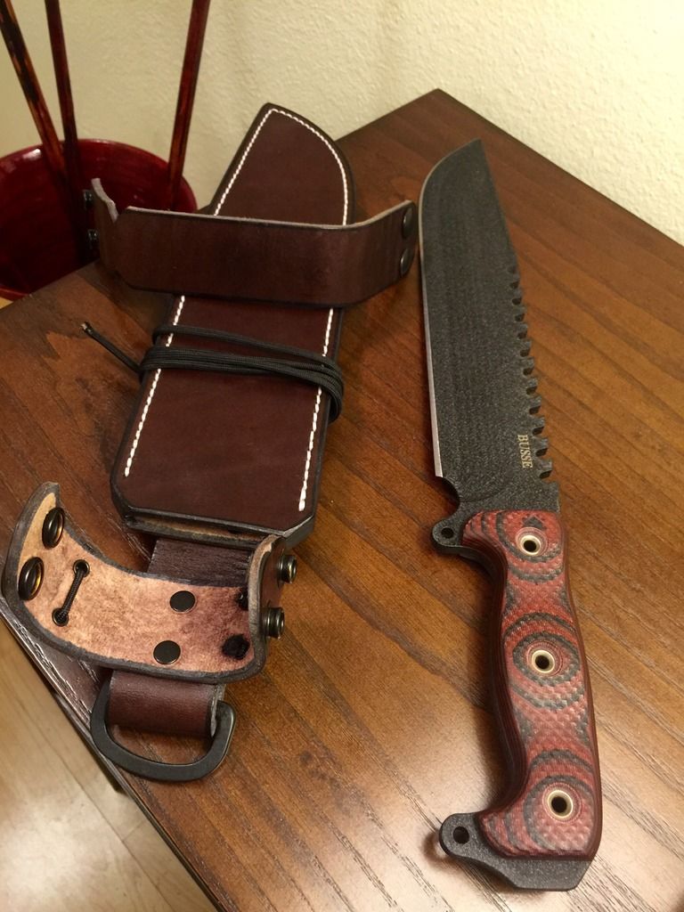

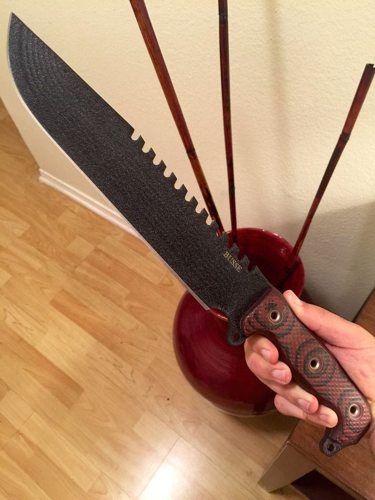

Oh my oh my --- I knew I'd like it --- but I had no idea it was this bad a$$ and stunning --- big thanks to Ron for this and the sheath -- stunning
Nice! Looks to have a nice thin bevel too huh? I say that sole based on what looks to be a higher than usual secondary
You are absolutely right --- it does indeed appear thinner than others --- I can't wait to put my mirror polished edge on this beast --- and then --- when I strip it ---- it'll just be in a league of its own --- if only I can get the mirror polished blade profile like the CGFBM you recently finished ---- zero friction forces -- can't wait!!

How can you tell if one is the thin bevel or not? What bevel does this have?
I can't, its all a guess, but in my experience a higher secondary, meaning, more metal ground and exposed, equates to a thinner bevel on a 1/4" thick knife.
That one does look like it has a thinner bevel..

Seems there might be a bit of confusion about edge terminology. And perhaps it's me who's most confused...:o:confused:
But wouldn't a...
"thinner" behind the edge blade stock equate into a "shorter" less noticeable V edge
Than a
"thicker" behind the edge blade stock?
IF both blades were ground at the same angles on the edge? <secondary bevel>
I could be wrong but my experience is A 30 deg. incl. V on a BattleSaw is gonna look more noticeable and taller than a 30 deg. incl. V on a razor blade thin stock.
I'm too tired or I would drag out and photo my Scrapper 5 and my Spyderco Caly Jr.-- both sharpened by me on my EP to 15 dps. The Scrapper has a nice tall and showy mirror bevel and the poor Caly Jr. barely looks like it's even got a secondary bevel.
So, it's my thinking Tim's claiming the Saw's that have a "shorter" less noticeable edge are the thinner ones.
But for that to be true in all cases we'd have to first agree that although some Saws seem to vary in thickness behind the edge, but all are IDENTICALLY ground in terms of their working edge...offhand, I'd say that there are more factors to be considered. :o:confused:
