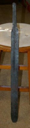

I am working on a sword for Ashokan, and will be posting a sort of WIP as I go along.
The billet is a composite with left and right twist center panel, and plain edges. The center makes a herringbone pattern. The herringbone is 1084/15n20. The edges are 1084.
Many thanks to Rob "Decker' for doing the build up of this billet.
The tip of a sword with a center panel has to be welded in such a way as to have the edge flow around the center at the tip. This can be done by welding the edge to the core in a long "U", but that can be fraught with problems.
I chose to do a butterfly weld. In such a weld, you make a curved "V" cut in the end of the billet, shaped like the inverse of the tip shape desired. You then forge weld the butterfly into the tip. If all goes well, the edge will flow around the core with little or no visible weld line.
OK, this one came out pretty good. I drew out the end four inches after the weld to make sure it was solid and see how the pattern comes out. I like it. It looks much better than these quick and dirty photos.
The photos are of:
The butterfly cut out shape drawn in red.
The final tip after a quick sand and etch. The bright line is a scratch.
The pattern after the weld marked in red.
The rough billet showing the herringbone in red highlighting.

I got out in the forge for an hour after the big storm blew through yesterday, and drew out all but the last part of the tang. It is now six inches longer and 25% wider. I will draw out the tang to the final size, clean up the bevels enough to check the center placement, and draw the edges out about 25% more this weekend.

I use a grinder where one is more efficient than an 18" bastard file. A file will leave a long smooth surface and a grinder may make a wavy surface. On a 3.5" knife blade the wave won't show, but on a 24" sword, it can be a problem. When I am knocking off the scale and dents, the grinder is the tool for the job.....My momma didn't raise no fool.

The billet started at .350" and is going to forge down to a distally tapered blade that is about .250" at the ricasso. That figure will be reduced by the wide fuller that will be the width of the herringbone center.
The thickness between the fullers will be about .100", and the thickness at the herringbone-edge ridge will be about .200".
The fullering makes the blade about 20% lighter and moves the balance back toward the hilt, thus reducing the pommel weight as well, and yield a lighter and faster sword. It will effectively make the blade thinner....with little or no loss in strength.
