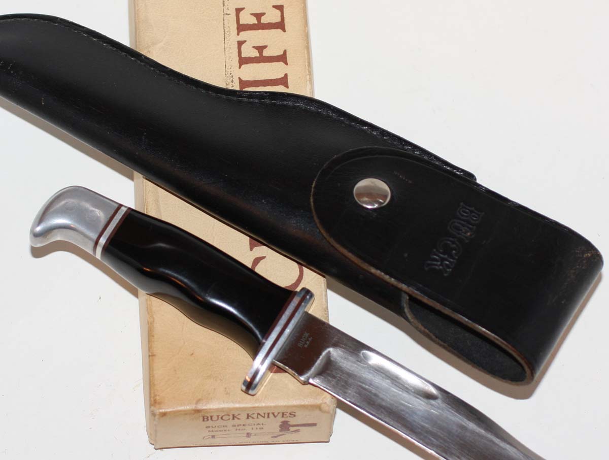

Here is a 3 spacer 119 with a swivel sheath and a sales receipt from 1977. Pretty good evidence that 3 spacer 119s and swivel sheaths appeared earlier than suggested.
This is correct. I have the same purchased new in 1979. Also have customer info card dated 12/78 with it in yellow one piece box.

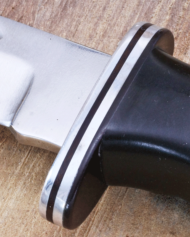

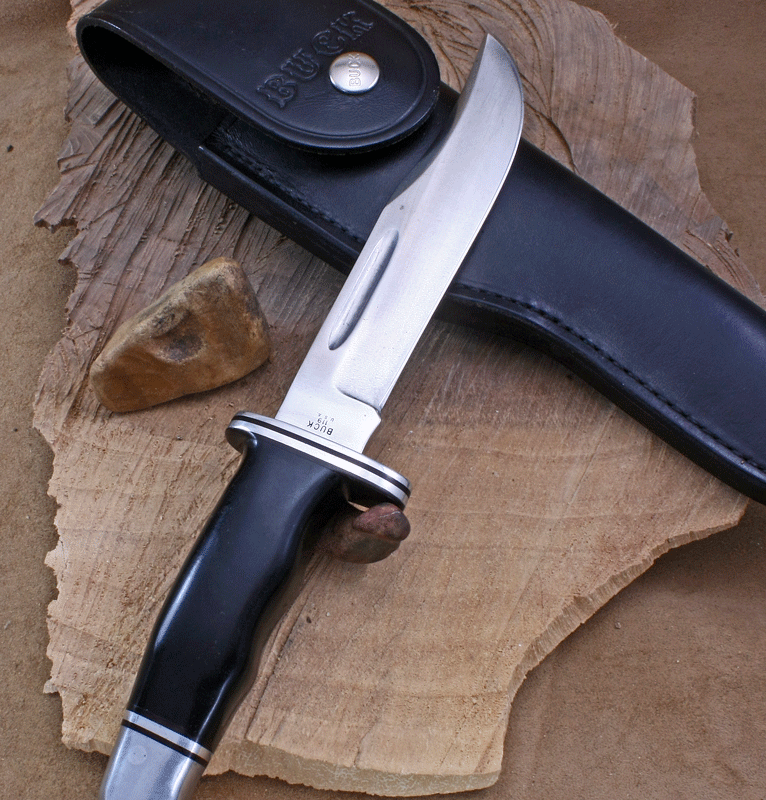

Was going to post these as my Sunday Picture Shows photos. But, with the 110 flood, didn't seem right. Besides this more 119 science fair stuff. 300
My odd upside down stamped, three line, four spacer 119.

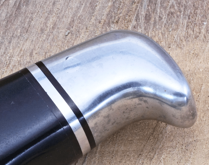

Placement of fiber washers (2) at guard of same knife.
Pommel of same knife with two fiber washers. Note tiny nic in edge of pin hole and/or pin..
Sheath I got, for better or worse till death due us part.

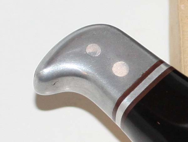

A recent purchase the first I have seen an early 2 line blade with 2 rivets in the but cap. is this unusual ,Looks factory, or a possible repair ?
Some call that as having; one is a pin and the other from a plug on the mold. Your knife was mfg. between 1969-1971. DM
