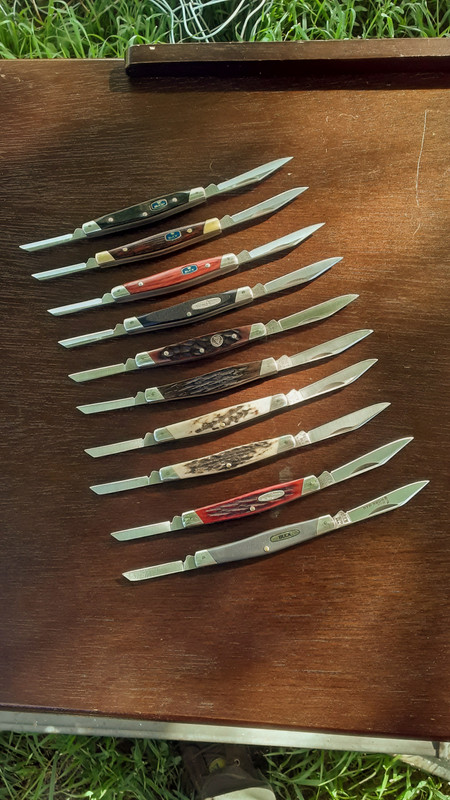

The 305 is my favorite Buck model and the only one I truly accumulate, but this will still give you an idea on how the in house 300 series blades changed over time as the changes applied to the entire 300 series.
Starting with the 1985 grey handle Workman series on the bottom, in order there's an '88, a couple 89's, a '90, a '98, an '03, '14, '15 , '17.
This is also most of the different cover options that have been available on the 300 series over the years, minus 2 types of yellow synthetics 2 different red synthetics I don't yet have and anything only used on certain knives, just in case you get a standard black one and decided to get another in a different handle material.
Examples from the mid 2000's+ are a little less consistent in blades because of tooling age and the best craftsman retiring...etc, the golden era of their slipjoints was was definitely '85 through 90's but I don't know exactly when they started to decline.
My '03 black delrin isn't bad at all, but still missing some of that earlier magic.
EDIT : I'll have to get a better picture focusing on the blades themselves tomorrow, I just noticed in my picture that you can't really tell very well.
Basically they went from an almost full flat grind to a very high hollow grind then to a hollow sabre grind around 2000.

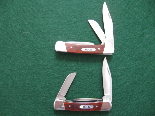

At some point, they switched the 700 series Stockman from the traditional blade position and moved the spey up front with the clip. I had purchased one of those, but found the F & F lacking. I returned it to Buck and they promptly replaced it with one that had excellent F & F but had the newer blade configuration.
Good call. The switch took place in mid 1986. These two 703's are both from 1986. The top knife is before the transition and the bottom knife is after. As mentioned above, they also added a third backspring when they made the transition.
