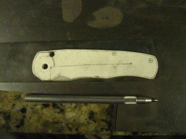

Here's a pattern made from white acrylic. I used it to scribe out all the major pieces onto the raw materials.
I made a card stock scale/bolster pattern and cut them out to scribe the bolster and scale. Since the bolster will be dovetailed with the scale, I added 1/8" extra length to the front of the scale when cutting.

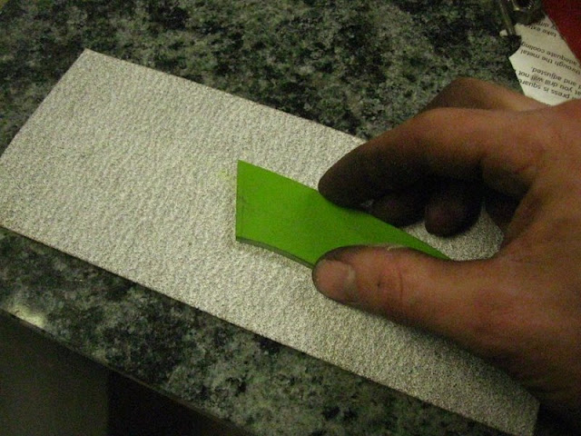

The G10 (from AKS, like most of this stuff) was 1/4" thick, a bit hefty for a folder scale. The bolster is .160 stock, and I'll want a little palm swell in the scale, so I milled it down to .187.
I flattened it further on granite with paper.

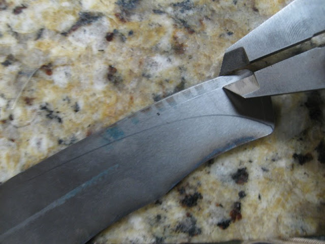

The blade stock was a rolled out bar of uneven thickness. It was thinnest near the heel of the blade, so after clamping to the mill table, I lowered the 4 flute HSS end mill until it was lightly cutting the heel, then traveled with several passes and plenty of oil at slow speed and feed to flatten half of the blade, then with the cutter still locked in height, re-clamped and cut the other side flat. This stuff mills OK too, just slow with HSS.
I ground the milled surface, then flipped the blade and milled the other side. Finished thickness ended up at .135. A little thinner than I'd first projected, but fine all the same.

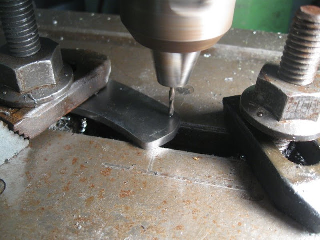

Next I drilled the pivot in the blade. Since I don't have a 3/16 transfer punch (on the list) I used a 3/16 drill bit spun by hand through the pattern hole to mark the pivot location on the blade. I did the same with the lock side of the frame. I then carefully center punched on the marks made by the drill point.
I drilled the pivot on the mill, as the spindle is nicely square to the table. First I used a #1 spotting drill for accuracy, strong light, and the XY table to zero in on my punch mark. The bit was running, and I looked from several directions to make sure it was centered, then drilled until I began to hit the c-sink.
I didn't move anything, just replaced the spotting drill with a #14 cobalt drill bit. This is undersize for 3/16, just enough to ream for a good fit.

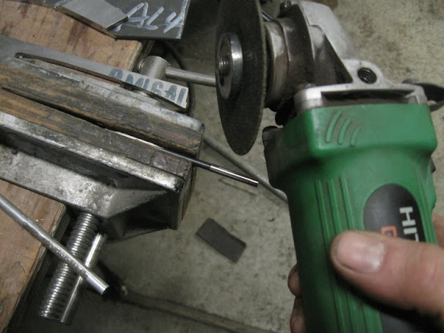

I used a 3/16" HSS chucking reamer to clean the hole to size. I couldn't find my older chucking reamer, so I cut down a new one. I used an angle grinder to cut the top of the shank off, shortening it to a less flexible length.
I clamped the TI frame and SS liner together with the frame on top. I then used the same procedure to drill and ream them for the pivot. I took the SS liner away, stacked the frame on top of the bolster piece with the edges aligned, clamped, drilled, reamed.
I took the bolster away, and flipped the frame piece for counter boring. I used the 3/16 reamer to locate the pivot hole, then swapped it for a 9/32" cobalt drill bit. I drilled down into the pivot hole with it, stopping with appx. 0.030" left before breaking through. This is about the depth the back of the pivot will sit flush.
I swapped the drill bit out for a "L" HSS chucking reamer, also with a cut-down shaft. This reamer is further modified by grinding most of the taper off of the tip, leaving only .020" or so of taper at the end, just enough not to bind. This enables me to reach the bottom of my drilled counter bore. I reamed the 9/32" counterbore to the bottom with the modded "L" reamer. This allows a light press fit for the pivot pin.

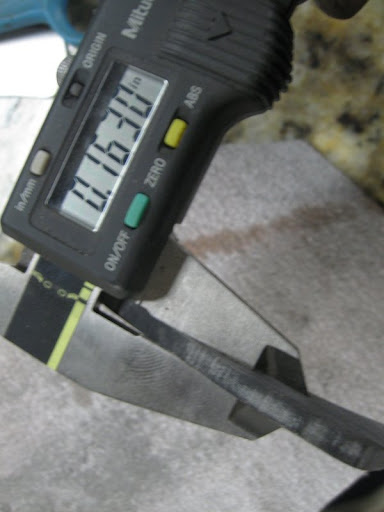

I then sanded them down to .163 on granite. .163 is the thickness of the blade with the washers (.015 ea.) added.

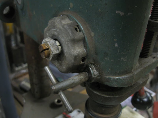

I drilled the liner holes with a #51 bit, then tapped them with a HSS 2-56 tap. I used the hand tapper I made from an old drill press. The top pulleys have been removed, and replaced with a flywheel and crank.
The spindle has a coil spring that can be set for downward or upward pressure of varying strength. The tap is merely chucked in.

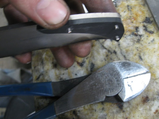

The screws needed to be trimmed for length, first with a nipper...
