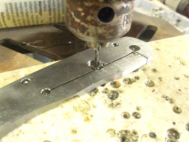

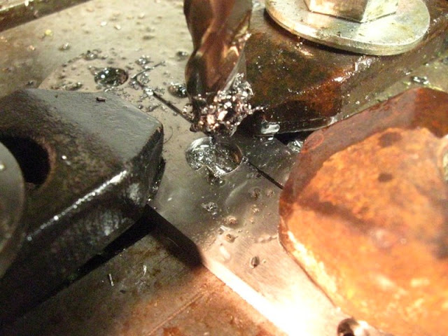

The disc is 3/8" diameter with a counter sunk clearance hole for an included flathead torx 2-56 screw. So, I chucked up a 3/8" end mill first, to mill/drill a recess for the disc to sit in. I used a 3-jaw chuck rather than a collet for the end mill. I did this since I’m using a round column mill- the quill only has so much travel for drilling, and the head when adjusted separately does not hold center on the table. The clearance necessary to change from a collet to a chuck with R8 shank for the center drilling would necessitate raising the head, and losing my center. So, it’s chuck all the way.
I milled the 3/8” pocket for the disc, checking the fit occasionally until the disc sat just a hair above flush with the surrounding TI. I un-chucked the HSS end mill and chucked up a spotting drill, for accuracy in drilling the center of the milled hole. I drilled with the 1/16” HSS spotting bit until the c-sink started cutting.
I switched to a #49 bit, drilled through. I c-sunk the top of the hole a bit more to improve tappability.

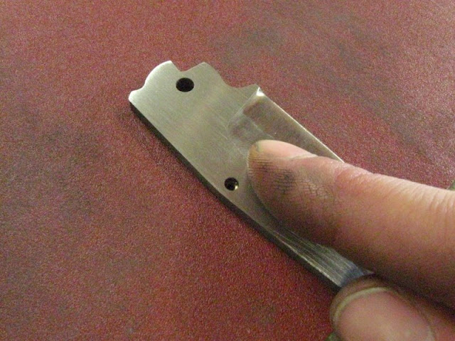

I took the frame over the hand tapper, used lots of tapping lube and patience to tap 2-56 threads into the center hole.
I installed the disc and screw, clipped the screw end off, and ground flush to the inside of the frame. Fits good.

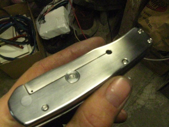

Now, to shape and sand the handle. I ground the edges and contoured the scale with a gold 967 roughing belt first, then moved to 220, then 400 j-flex belts to refine contours.
220 j-flex.
A dirty 400 belt finish.

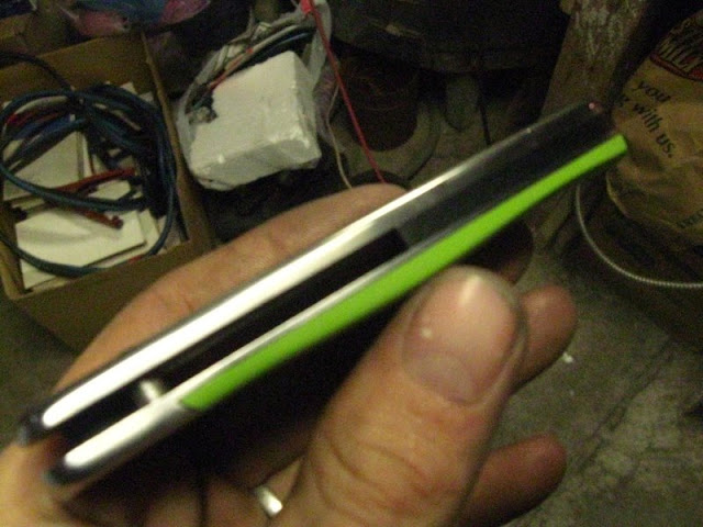

Sides at dirty 400. The green G10 stays dirty until the end.
I started hand sanding at 400, with Redline paper on an eraser backer. Then I moved to 600 on the same backer. At 600 hand sanded.

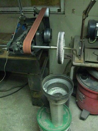

Next, I went to my buffer- or rather, the buffing tooling arm I recently built for my 3hp variable grinder. This thing works great, it has a Baldor quick-change cone arbor on it, very convenient. I hit everything lightly with pink scratchless rouge. The scale was taken off and buffed, due to cross-contamination coloring of the G10.
