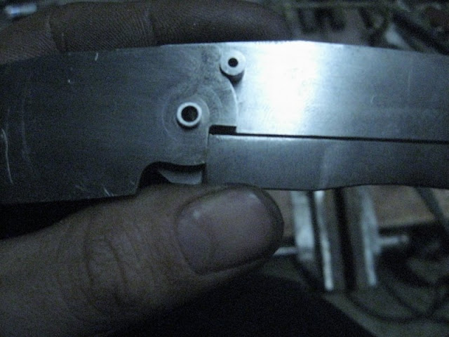

I drilled the top hole out and reamed it to 3/16," then used the liner to locate the opposing hole in the frame for the stop pin. I drilled through the liner to make a blind hole in the frame, and reamed it to 3/16".
I drilled through the blind hole with #43, then counterbored the backside with #19. A shortened 3/16" threaded stop pin now press fit into the frame. With the liner installed, it press fit into the liner.

With the pin in, the blade stopped a little short of where it needs to.

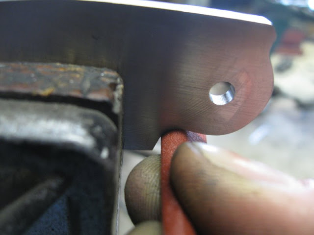

So, I used first a chainsaw file, then 280 paper wrapped around a 5/32" bit to shape the last bit on the closed position stop pin area of the blade. I like to shape this area round to provide more surface for the blade to stop against.
I made sure that the blade was correctly aligned against the handle in the open position by filing and sanding.

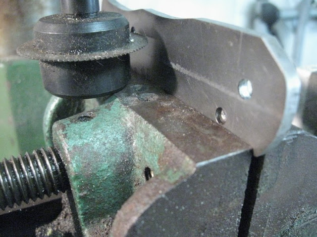

I scribed the lock onto the frame to mark for the cut. I took a small straightedge and scribed a line back to the end of the lock bar. I punched, then drilled a #19 hole at the planned end of the lock bar.
Now for the fun part, cutting the lock bar out. I threw a cobalt slotting saw in an arbor, colleted it into the mill, and dialed the speed to 90 rpm. I clamped the frame in the vise, making sure the scribed line was parallel with the top of the jaws by the use of the small steel ruler.
I plunge cut the start of the kerf with slow feed and plenty cutting oil. The cut started ahead of the drilled hole, and plunged in until the saw broke through the front of the hole, but not the back edge of the hole.
I ran the table back very slowly, again plenty of oil, until the blade had reached the end of the line on the inside of the frame. I don't know technically what the feed rate was, as it's a manual table, but I probably took five minutes to cut the long side of the lock. Those little blades are spendy and easy to ruin on TI.

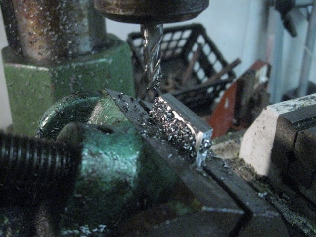

Next, I chucked up a HSS 5/16" endmill (have a carbide, but no collet the right size.) I slowly cut the lock relief in, leaving about .045" at the bottom, and ran the mill forward 3/16" or so to provide a bit more flex area for the lock.
I used my DeWalt portaband to cut the end of the lock (the blade is narrower than the bigger saw), then finished cutting the long side in with a ground thin hacksaw blade.

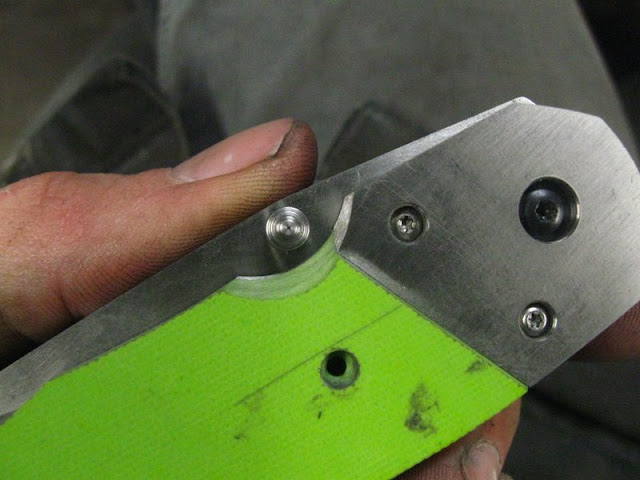

Now to bevel the back of the bolster. I took the bolster over to the mill, and used a straightedge to set it in with the back parallel with the jaws. I used a protractor to set the angle vise to 30 degrees. I used the same HSS end mill to slowly cut the dovetail angle with multiple passes.
I set my platen to a similar angle, then try-fit and ground the scale front to match the back of the bolster. I superglue tacked the scale onto the liner with the bolster installed.
I marked out the location for the three scale screws, drilled through the scale with #43 and through the liner with #51, tapped the holes, counterbored the scale, and installed the scale. I shortened the screws by clipping the ends off with them installed in the liner, then grinding flush to the liner surface with 220 grit.

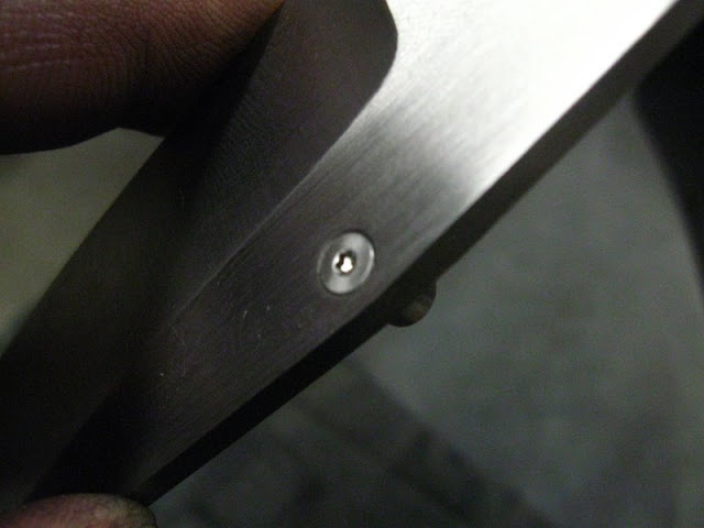

At his point, I ground all the edges flush for a smooth profile.

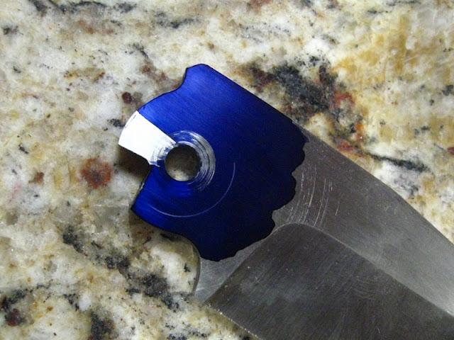

With the ball pressed in, I dyed the reverse side of the blade with Dyke, all around the pivot area.
I put the blade back on the frame side, with the pivot and stop pin installed, then closed the blade. This caused the detent ball to scribe a line in the Dykem.
I center punched for a hole just about .020 in front of where the detent scribe line ended. This will place the center of the hole just in front of center of the ball when in the closed position, causing it to not quite fully fall into the hole, providing a more positive holding action. Also, this will hold the lock bar slightly off the blade, to prevent scratching.
I drilled the hole with a 1/16" bit, about 1/16" deep. I deburred and stripped the Dykem.
I reassembled and checked the detent action. It didn't fall in the hole quite as much as I wanted, so I enlarged the detent hole slightly with a larger bit. Checked again, it works just right.

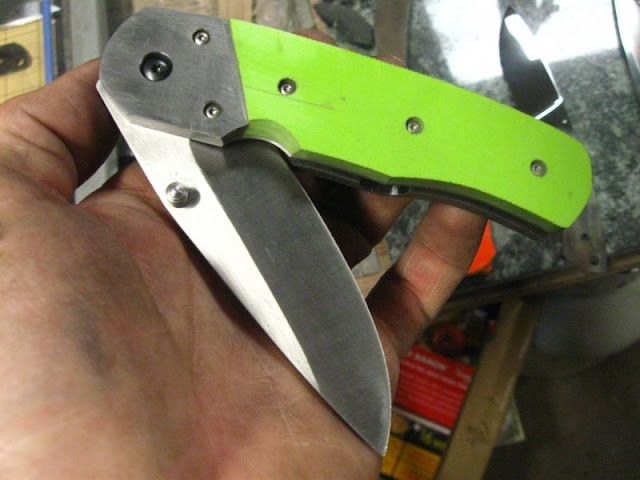

I assembled the knife again, the closed the blade to locate where the relief notch for the stud will be. I marked it with pen.
I rough ground the relief in with a 5/8” wheel, at 220 grit.
A progress shot of the knife as it is now.
