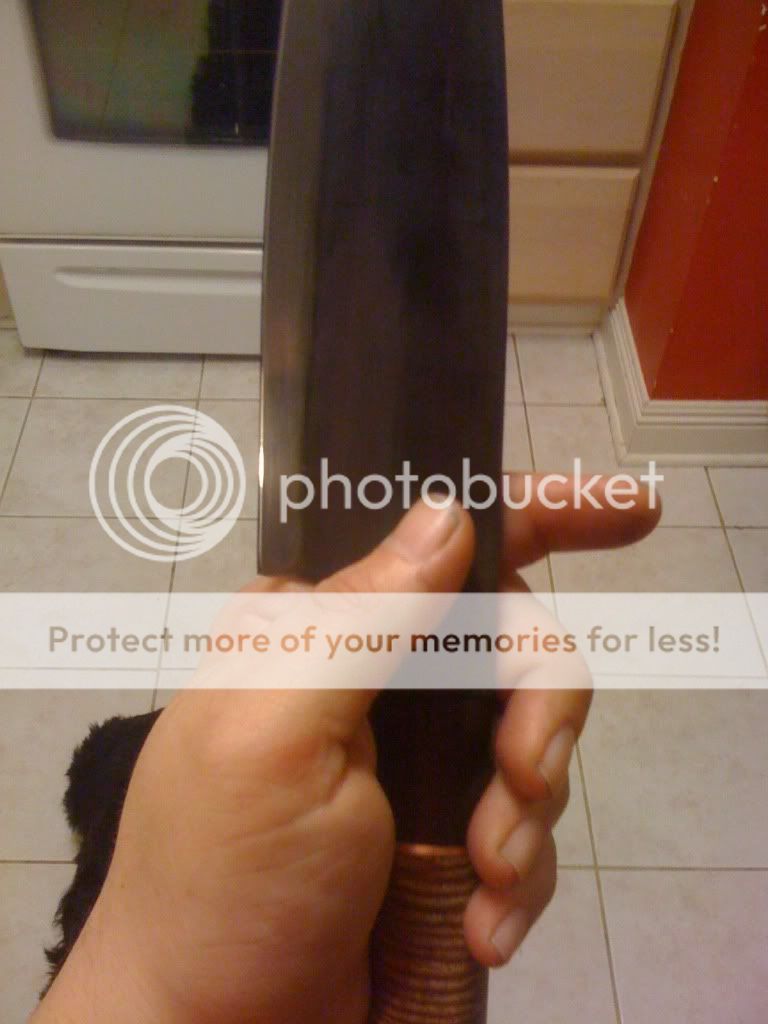

SO im sitting here about to sharpen the blade and wondering.. Should I sand the etch off and just polish the blade up fully? or leave as is and just sharpen it up? What you guys think?

As far as the etch goes, I would personally leave what you have. Looks good now and it's going to turn anyway as a carbon-steel user, may as well give it some "guidance" up front. You might protect the flats and bolster corners with the clear plastic tape you already use until you're satisfied with the working edge. (Painter's tape can jack with your etched surface in short order IME.)
You should have another go at the original design. If so, make it as thin as you dare (from both spine to edge and tang to tip) and make sure the edge's heel is dead straight/true to the cutting surface for at least half the blade's length - preferably two-thirds. These are two common shortcomings that are easily avoided up front. (They're hard enough for new owners to properly maintain - last thing you want is for them is to feel driven to reshape the primary bevels/profile to get the expected performance.)

Putting a nice micro bevel on it. Hard to get pics for me especially with the cell phone lol

I agree with everything here, but i do have to disagree with the dead flat heel. You will end up with a knife that thunks into the board when using rocking motions. According to the chef's i deal with all the time, a very slight curve to the cutting edge is better than a flat.
Not to derail your thread, just adding a little insight from a bunch of pro chefs.

Dimensions are 5 1/2" handle and blade is 8 3/4' with 8" of actual cutting edge. I wanted it to be a good all around kitchen knife. Im thinking of making a twin with a thinner 4" blade for a matching set.
