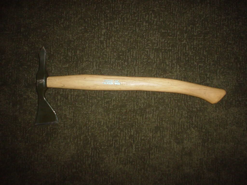

i just handled my first VN hawk this year - the Cold Steel version.
....i like the concept, but i was surprised at how heavy it was, out of the box - and my big hands had almost no control around that itty-bitty, slick handle they put on there.
i thought it would've been less massive than the Trail Hawk, which is how i would've done it.
VTACs, or course, look great, and must handle better - it looks like they are not as massive as the CS versions of the LaGana design, and have a better handle countour.
i am supposed to get some of those VTACs to re-handle, but not being able to wait, i started using the CS VN hawks as test subjects.
the first one i "poll-axe'd", and i liked it a lot.
....but i wanted a more standard-sized hawk, and thought i'd try a few different lengths on the Gen 1 handles.
here's the 24-incher, my favorite so far.
a lot of folks here are wisely modifying their Cold Steel Trail Hawks - have you brethren considered doing that to the VN hawk from the same company, or even the VTAC...?
i bet you could trim a straight-grained handle down and put it in the VN hawk for a better grip.
i think a longer version is in order.
if you have done this, could we get some pics...?
....and how'd ya like yours...?

I picked up a roofing hammer handle for the VN. It was longer and thicker. The ergos were tons better than the stock handle, but my head/haft attachment was fro crap so it self destructed pretty quickly. I will have to try new attachment methods.
that was exactly what i was thinking folks could do at home, brother 'Insano.
maybe you could drill straight down the middle of the haft with a 1/2-inch bit, then coat a long 1/4 " machine screw or metal dowel down the hole coated with two-ton epoxy, for strength.
by nature of what it is, that little eye is hard to get hafted right, and with lasting strength.
vec
Some here have seen this before... This is a perfectly shaped handle and this hawk is almost hyper it is so lively in the hand. Why, oh why can't there be an outbreak of zombies?
that's what i am talking about.
send me that beauty, and let me paint it and epoxy-seal it, brother 'shooter.

Vec001. The above hawk looks great. But in my opinion of a longer handle on the VTAC's is that it would hinder the performance of what they were designed to do. #1 for military use and possible close quarter combat and #2 throwing. I think the longer handle would get in the way. And a origional Lagana I would not touch.
Please dont get me wrong I think your work is great. Infact I have an order in with you. But I dont think everything needs a longer handle. If I do end up with a VTAC head only I will send it to you for the handle work..
Keep up the Great Lookin Work..
right - key words are "designed to do" - i have other designs on this ...uh ...design.
i don't think everything needs a longer handle either, and i am sorry if that is what folks have gotten from my commentaries.
the longer handle in the case of the VN speeds it up and lets you recover faster though, when you hold it tomahawk style (where the last third of the handle meets the middle third), because of physics and the Gen 1 Contour, vice axe holding style (at or near the end of the handle).
the longer handle also lets you use the spike to comfortable drag logs and lumber along with you (or a body, in war), so you don't have to strain to pick it up, or use the edge of your main bit, ya dig...?
the longer handle also lets you deflect things easily when walking through boulders, for instance, and your reach is extended by the length of the haft.
(i do that all the time in some of my favorite remote hunting and primitve camping spots, through stream necks.)
the spike doesn't come back at your eyeball with a longer handle, when in gross-motor use (as in, panic) - it sails over the head and shoulders, even in the choked-up tomahawk hold.
a long handle makes a better splint.
....a better hammock pole.
a better tarp pole.
so you are right, not everything needs a long handle, but there is a short handle inside every one of my long handles,
...and there ain't one long handle in any short handle! ...:D....
