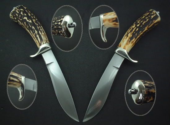

Forged W1 Blade mated with Hot-Blued Steel fittings in a Take-Down configuration.
Really nice specimen of Premium Sambar Stag.
Not easily seen in this photo is that the face of the guard is mirror polished. The back of the guard is satin finished. Corners are relieved and polished.
Outside edge of guard and ferrule are finish-sanded horizontally to 1200.
Butt cap mirror polished!
Overall 13.5 inches with an 8.0 inch blade.
Karl,
I have been looking at your knives for months, and they have great lines, and the work shows that you strive for excellence and are very creative.
That said, it is my strong opinion that the line of your choil is very odd, and the work would very well served if you would study the way the Kevin Cashen, Burt Foster or Tim Hancock do their choils, and incorporate some of those elements into your style.

Very nice looking. I like the line of your choil and do some the same way myself. It helps to align the bottom of blade with the handle and to me gives it good flow. Having good stag helps also.

1. The "all the maker gets" comment means that constructive comments will be MUCH more helpful than "great job" and that's it.
2. Have Don Hanson or Kevin Jones purchased a knife from you lately?
What can I tell you, Karl?
I noticed something, and commented on it. If you want to take that comment in the helpful spirit that it was offered in, great, if not, keep doing what you are doing, I'm sure that it is just fine.

I did not intend to offend anyone.Just stating that I like his style and and think it gives flow to the knife. The great thing about making knifes is that you can make them as you like them.Hopefully other people will like them also.I don't know if Karl takes custom orders but I will change the choil if the person wants something different. I like working in my style but will change it to make a customer happy.I just got a web site up if you would like to see some of my knifes go to www.hawesforge.com . If everyone liked the same thing we as custom makers would be out of a job.

STeven is right, we all need constructive criticism, more than just positive comments. I like my style of choil best, that's why I do it. But I recognize Karl's as his style.
If every maker made every knife the same way, and every collector's tastes were the same, what a dull knife world this would be. :yawn: :(
Different taste and philosophies by makers and collectors and communicating such in a positive way promotes a healthy knife industry.
STeven and I have very different taste in knives and we actually prefer it that way, as we are not always competing for the same knives and we both gain from each other's knowledge and opinions.
Cashen, Foster and Hancock sell out in 15 minutesbecause they are........well, Cashen, Foster and Hancock:D I noticed the choils on Karl's knives too and, while it is not the way I do it. it is a matter of personal taste. Just like whether you do them like Karl either the way he does it or with the plunge cuts all the way forward at the bottom of the arc, a flat bottom ricasso with a round choil, be it convex or concave, a straight one with a slightly rounded bottom, an angled staight or slightly curved choil with a hard transition at the edge, the "butterfly", etc, etc,or all of the above,like me......mostly because I have had to "fix" the choil......lol. OR no choil at all like Ed Fowler and others. It's all good:D

But that little "thing" I have going now is not the only choil I use, have used, or will use! It's just what my next couple dozen customers have already ordered and seem content with. To respond to a comment above, yes, if a customer wants a particular look to his knife and it's something I am willing to create and have my name on it, I'll do it! This is the only thing I do for food on my table, and I get hungry a few times every day!
Maybe to a few people's chagrin here in the future, that choil is going to get MORE pronounced! Look out!
I jumped to a picture folder of mine and dug out a few different looks I've used in the past.
Some people may even call a few of my choils a "Fowler" style choil. Even though I've seen the EXACT profile on knives 200 years old! I saw one last year at the WKCC show, and if you covered the handle, it looked just like a "Pronghorn"! The owner said it was from 1790.

Karl; I'm a little late in this thread and I'm not a knife maker and I don't really know "git up" form "sic 'em" about collecting or building a good knife, but I do know what I like and I buy what I like.....and I really like your knife, particularly the choil. That's about all I have to say on the subject.

And all of those knives were done in those different ways on purpose and not because you screwed up somehting? you suck!!!! lol ;) Just kidding....great work. Question for you. When you thread your tang, what diameter and thread count do you use?:thumbup: When i see your knives, I don't care about the choil. the thing I want to steal from you is that tang nut you have devised....lol
