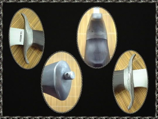

I didn't devise it, so you wouldn't be stealing it from me - you'd be stealing it from Jerry Rados and Jim Siska! That's who I inherited it from!
Jerry taught me, and he and Jim have been using it for years.
I use a 10-32 thread. Most of my ricassos end up around .200 - .215 thick at the guard shoulders. I tap my threads on the tang at about .185, which makes it through the guard easily.
