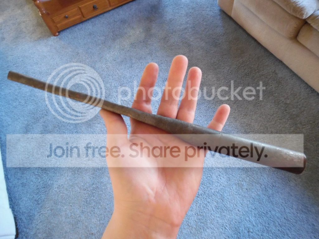

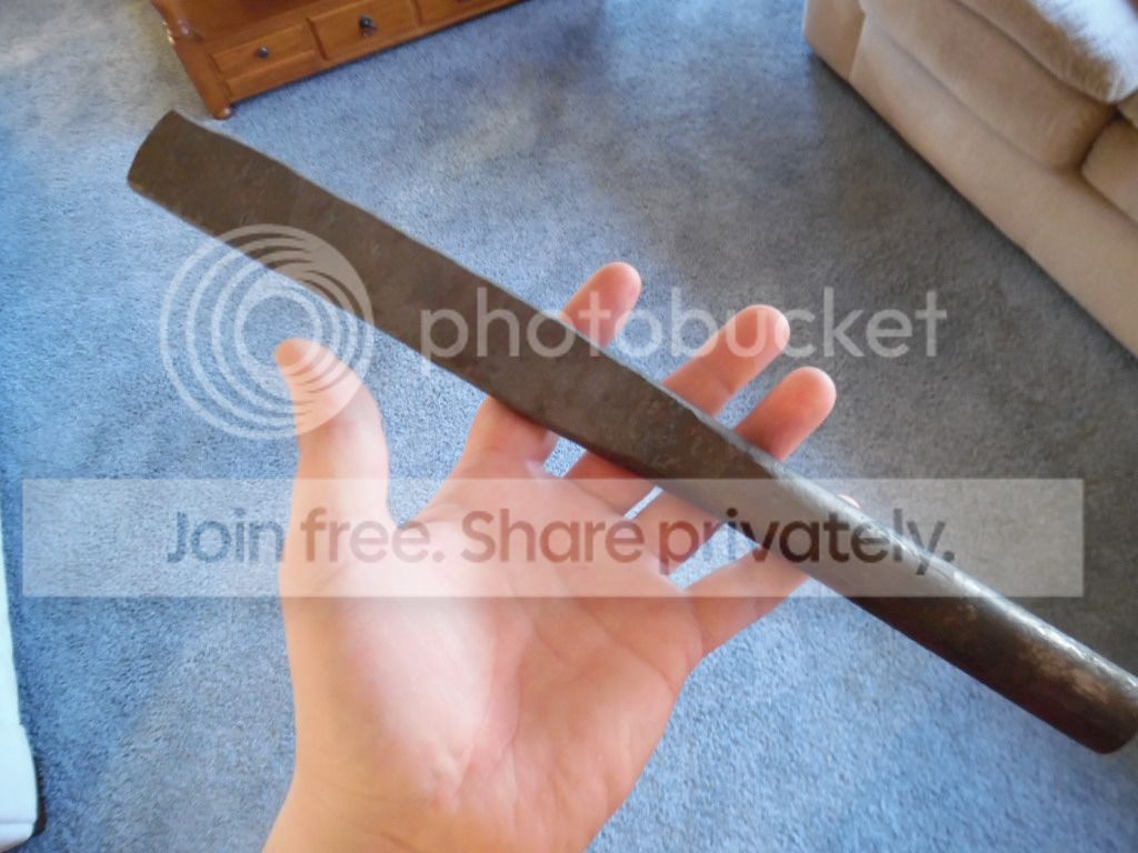

Here is my First attempt Forging from w2 rounds that I picked up here in the sale forum. Figured I'd post a couple pics. I have very little forging experience so obviously this isn't a tutorial. lol I don't know what I'm doing. I need to go to a blacksmith class. But I do have a question...
3/4 inch rounds.
After heat treat with clay coating and finish grind.
I have had better hamons with 1084, so there must be some different technique with w2? Is it in the coating or the polishing? The line is distinct, but has very little ashi, or shimmery effect. The hamon looked better after a quick etch then it did after finish sanding and the etch and polish. Here it is off the grinder a 2 minute etch in FC diluted 1-4.
Here it is finished, I tried FC, and lemon juice, but never got anything too amazing with the etch.
The desert ironwood however is the best piece Ive used.
Any tips on Forging or hamon creation with W2 are appreciated.

Very nice job! That polished brass might be a touch too much bling for the feel of that knife but when it mellows it will look nice. I like swedges too. But disagree that any bowie of this type without a swedge is missing something. Much of it depends on the overall feel and the profile of the blade. I think yours works fine the way it is. One thing you didn't show us was how you clayed the blade. The etch technique is a contributing factor to the hamon development but the clay is a factor in its creation (as is HT of course). It is not recommended to put the clay on thick. Here is what DHIII says about his W2:
Don Hanson III:
After normalizing, I heat W2 blades to 1450f, soak for 5 to 10 minutes and quench in Park's #50 oil. A 1 hour temper at 450f will give you around a 61-62 RC hardness. I temper twice for 1 hour at a higher or lower temp, depending on the size of the blade and its intended use.
W2 is capable of very fine grain and is a super cutting and tough steel but you have HT it properly for best results.
I shoot for 1450f on my W2 but up to just under 1500 is good also. Don't gobb on a bunch of clay and no need to heat the Park's 50.
Temper at 425f one hour twice, or 450f for larger blades.
Yes, too much clay on W2 kills the hamon activity, as does too much heat.
I hope you got more than one blade from that piece of W2. And didn't over heat it too bad? Multiple normalizing heats are required after forging...
Don, Yes there is enough for another blade on that piece. I don't think I over heated it and I did 3 normalizing heats after forging. I put less clay than I use on 1084 because I had read your advice on w2 multiple times, but perhaps I should try an even thinner coat? Thanks
Sound good Ricky. Yes, even less clay. If anyone gets a better hamon on 1084 than on W2, something ain't right! :cool:
