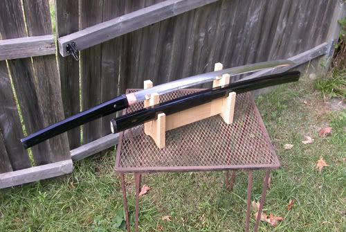

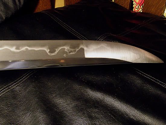

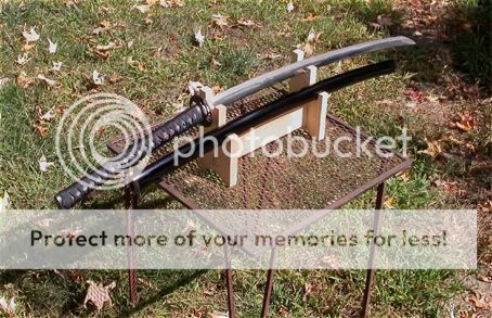

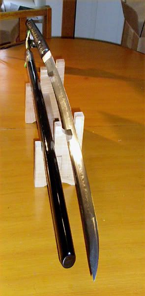

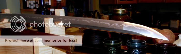

I've Made three katanas out of Dons W2. They all hold a good edge, are a lot springy-er(sp?) than I expected, I got killer hamons, and when first heat treated I took them out in the woods and "cleared brush" with them to make sure they were tough. So that's My story and I'm stickin' with it.
Matt
Sam, 30"+ sword from W2, no problem :)
Matt, we need to see pictures :)
Sam, also check out what Walter Sorrels is doing with W2.
You can anneal Don's W2 as soft as Silly Putty, so the trick on a long blade may be getting the spine hard enough again...lol
Well here you go...
Some of these I know you guys have seen before(You just want Me to try to remember My photobucket password) I'm reworking the "Kill Bill" styled one with a cool new wrap/menuki idea I had, so I'll show more pics of that when I'm done.
Matt
