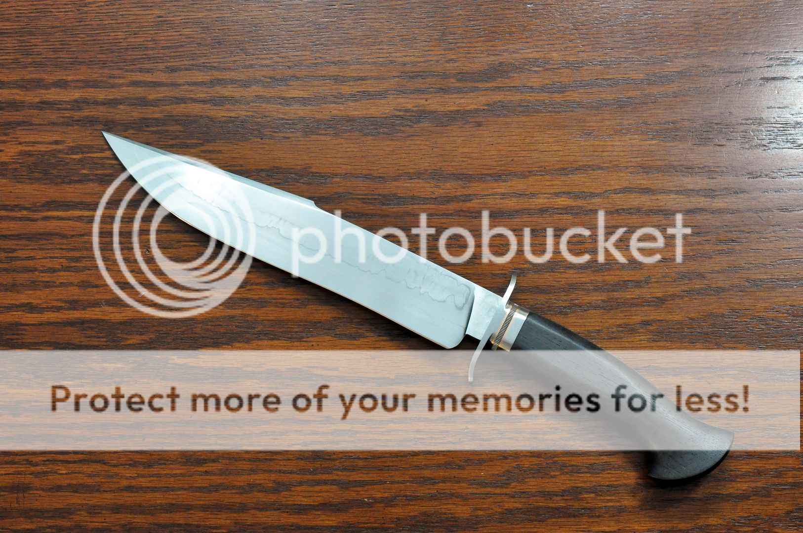

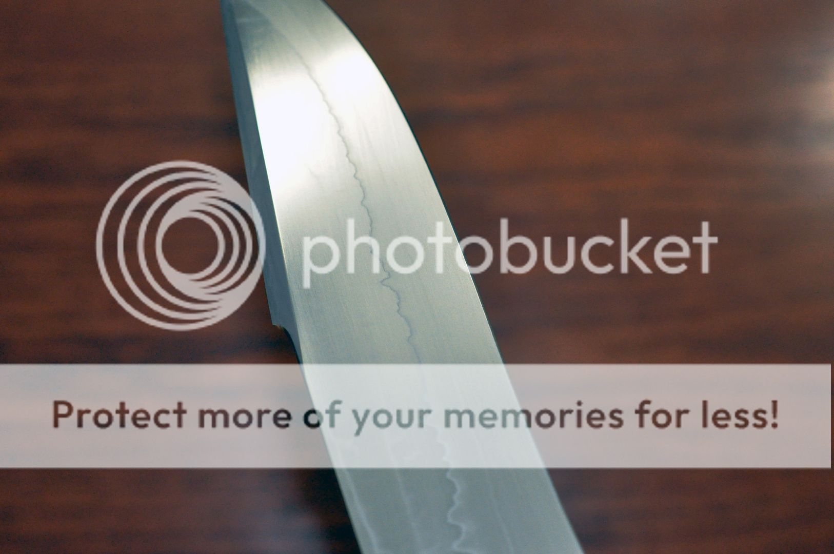

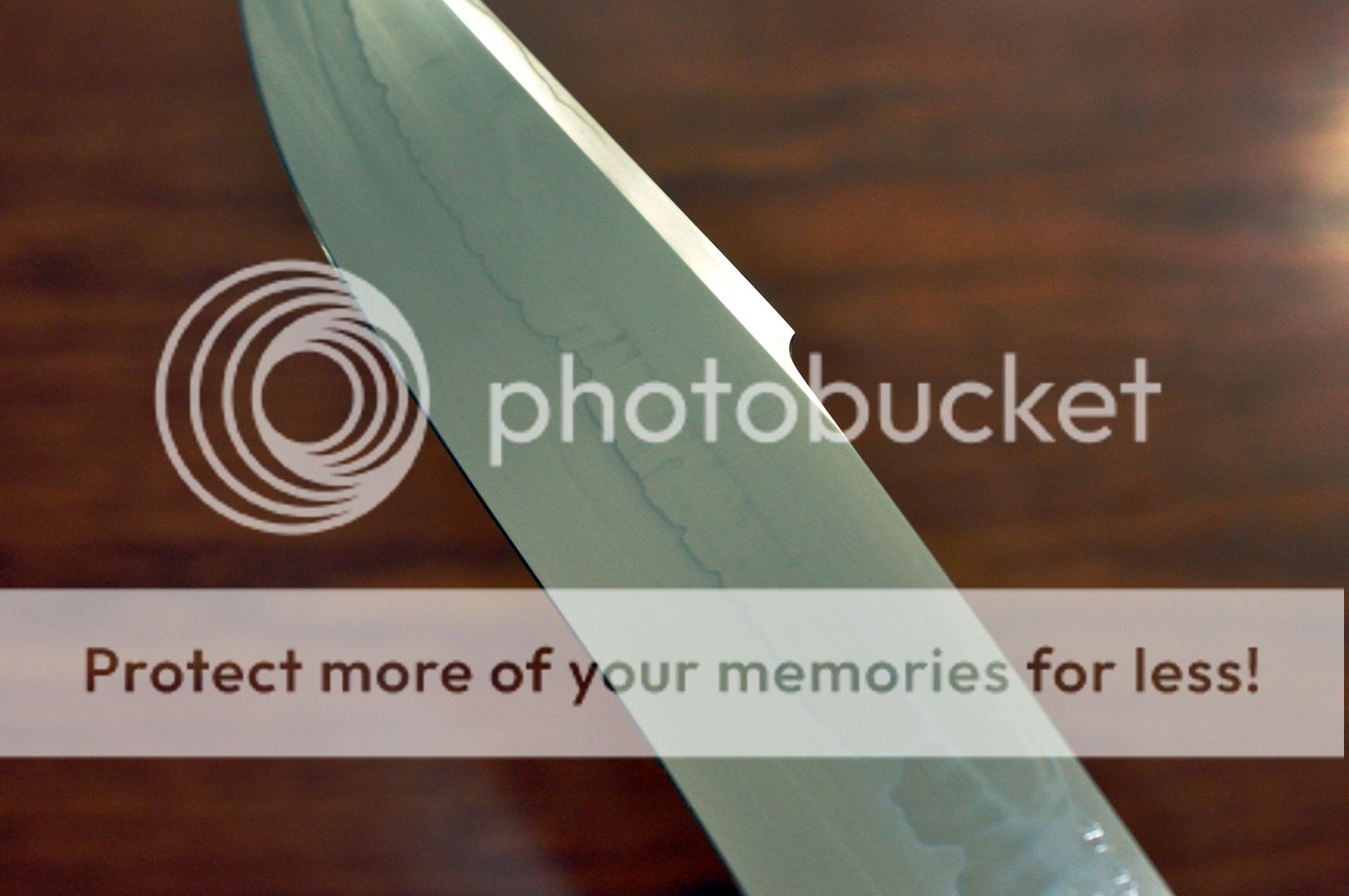

Here’s one I did with some old round stock w2 that was supposedly from DHIII’s.
Not the beautiful banding stuff, but there’s something magic in that steel.
D0B36836-4DD7-4965-BC14-05CC49E02814.jpeg 568A1407-F73D-49B2-94D6-DD038A3009B7.jpeg
Don't think I ever added this knife to the thread. My try at clay-less hamon with DHIII W2.
