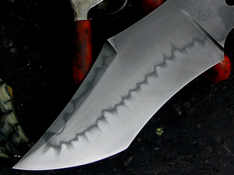

Thanks for that link. The part about the clay not being what determines the hamon makes sense to me now. Because the hamon I got on mine looks nothing like the clay that I put on the blade.
The clay might or might not define where the hamon is, but it's one variable amongst many. Temp, time, steel condition, type and thickness of clay, and quench medium and time all play a roll. Keep notes, and pay close attention to what you feel through the tongs during quench, especially if doing an interrupted quench.
I got part of one lip right on this one. I first tried for a hamon in 2012, and most of the knives I've done are differentials hardened.
[/url]image by Wjkrywko, on Flickr[/IMG]
This was using clay.
[/url]IMG_5926 by Wjkrywko, on Flickr[/IMG]
This was clayless

You guys with more knowledge correct me if I'm wrong, but banding can be "broken up" by a solid normalizing heat. It can also be "caused" by excessive time at spheroidization temps, or too many cycles in that spheroidizing heat range.
One normalizing heat wont get rid of it, the blade above was forged & normalized 3-4 times.

I'd love to hear from Devin about the banding Don! Maybe he will chime in. In the meantime, may I offer the source of where I got the idea that normalizing should fix it?
"Virtually all the desirable properties we want are maximized through homogeneity, banding is the opposite of this and many a scam has be foisted on the public, or other knifemakers, by exploiting general ignorance on the topic. Normalizing corrects banding, one good soak above Accm will pretty much erase it. But excessive slow cooling or excessive cycling at lower temperatures will bring it back." - Kevin Cashen, Hypefreebladeforums, thread titled "Wootz like etch patterns in 52100".
Stuart, I don't always agree with stuff I read on the interwebs. ;)
But yes, a good soak well above critical will erase it, then normalizing to fix the soak at high temp.
This is one case where I do not want to "correct banding".

Workin smarter is better than cheated I think. :cool: It looks better than my high layer damascus and it a whole lot easier.
Most banding comes from low temp forging and cycling. This stuff looks old. Banding is eliminated by forging above Accm usually.
