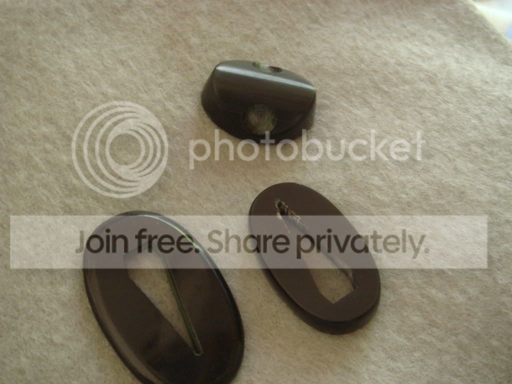

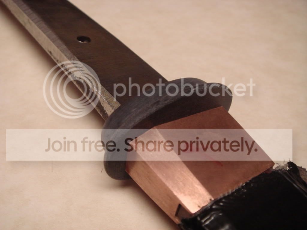

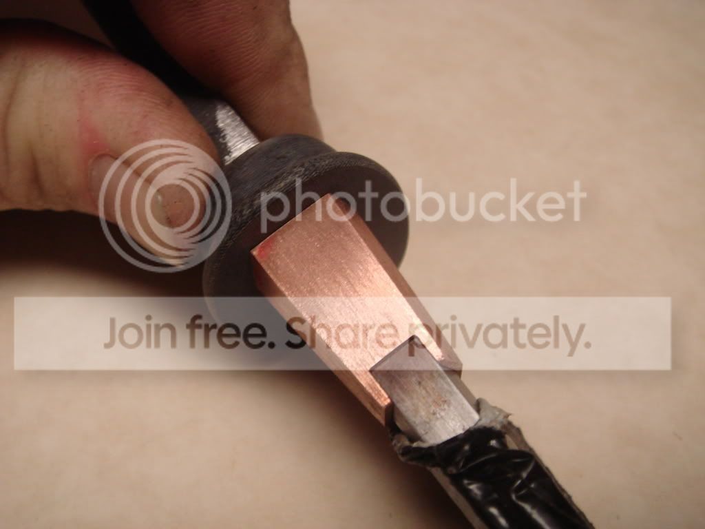

i carved the tuska out of grenedillo, as i wanted something hard. it works
okay... not a "big picture" of the "fittings" what are the propper names for
these things? and a close up of the best fit i have done so far... they slide
on perfect but are TIGHT.. no wiggling. gonna try and do a full take down,
with no glue
please let me know what you think
thanks
~Chris

Usually the sword is rough polished and then sent out for the saya work. The final polish will be the last thing to do after everything is fitted and the sword is ready to assemble. I'd get it close, but not perfect then finish up the saya and fittings.
you say that habakis aren't your strong point, but that one is beautiful! I love it!

the tsuba is linnin micarta, and the fuchi is horn the kashira is going to be a combination of the two when it is polished you have a hard time telling the difference, but the micarta is more... reslient

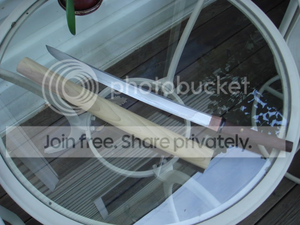

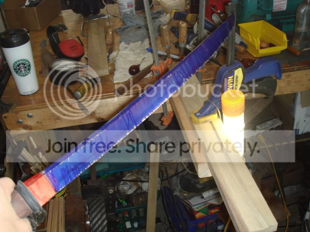

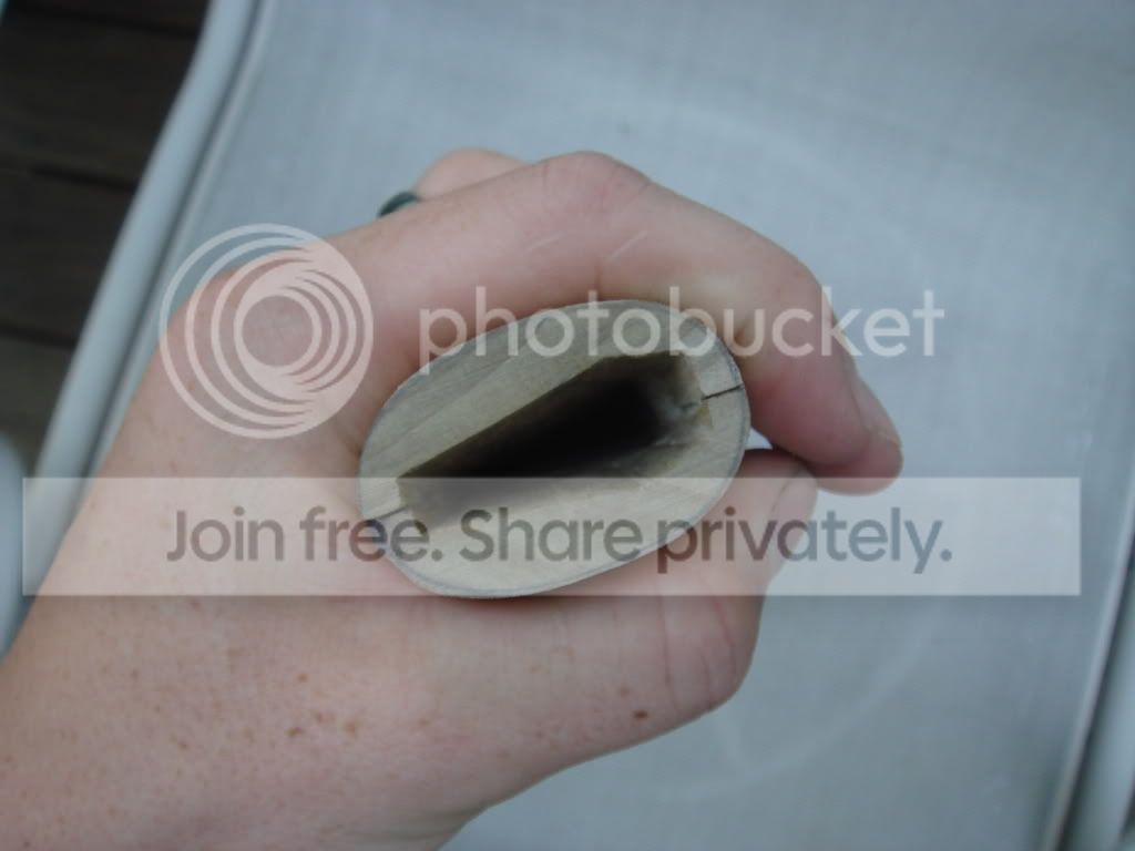

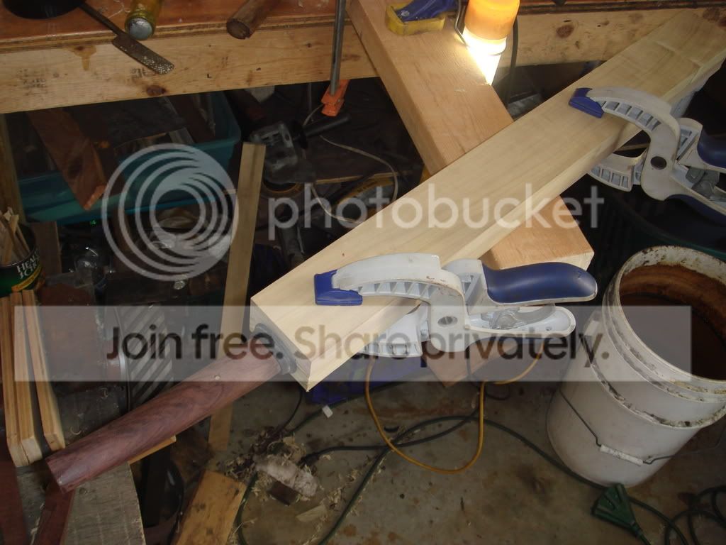

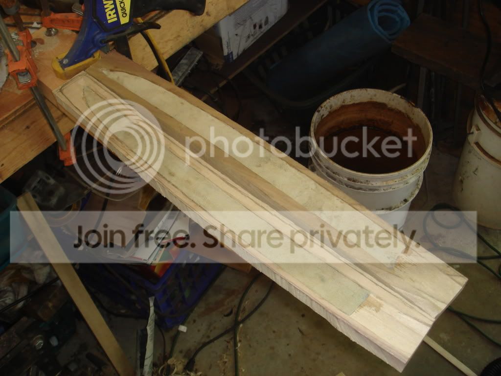

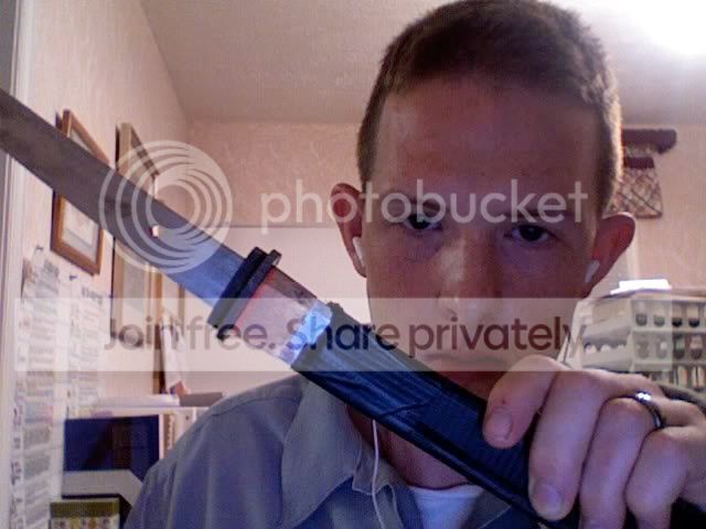

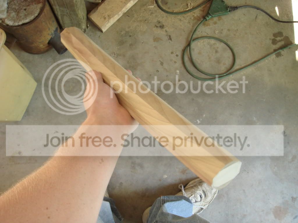

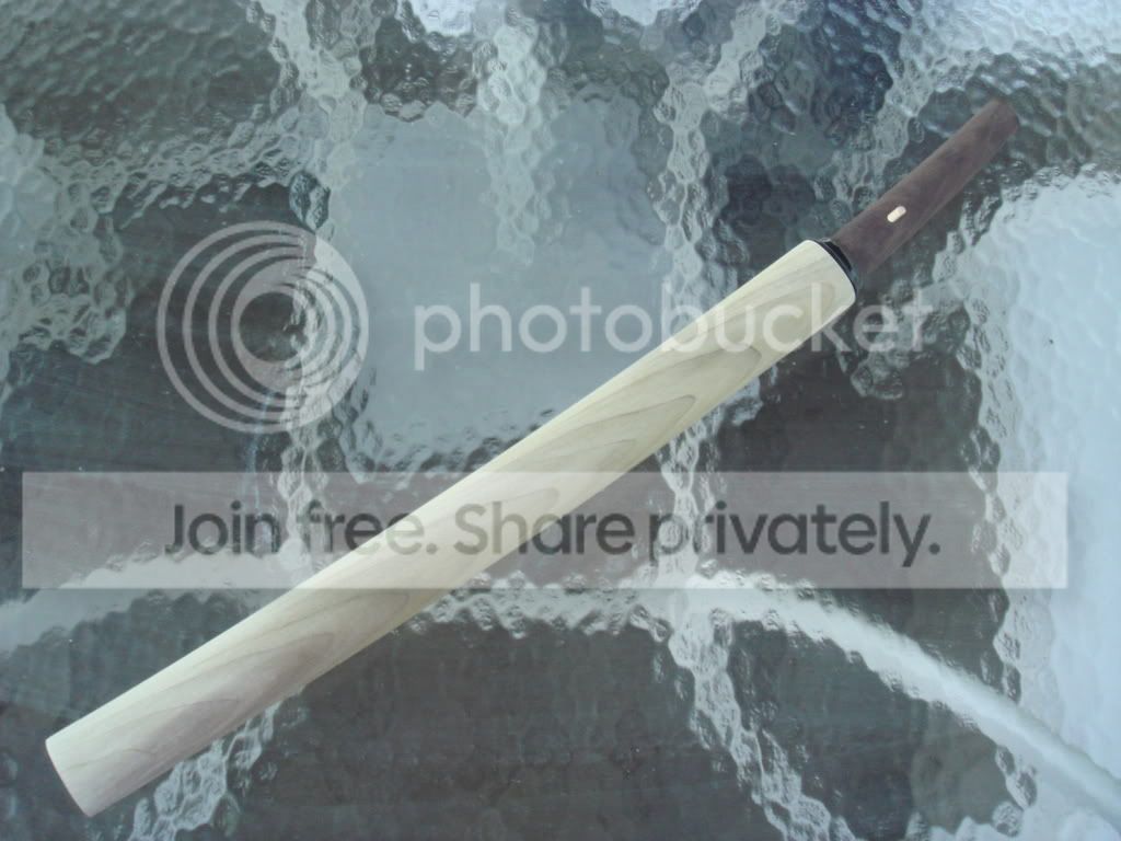

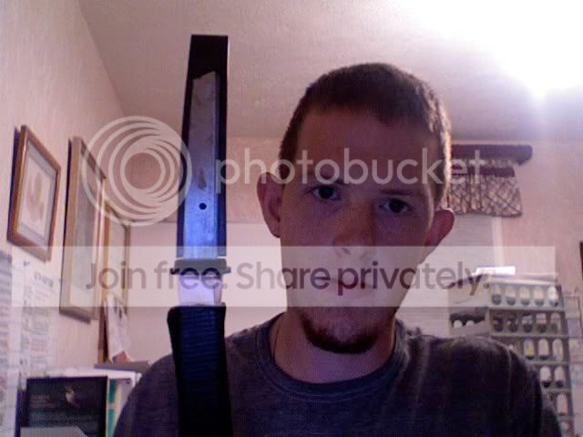

well i didnt get it done this weekend (i had to study too) but i did get the sheath and handle done. the fittings are done (except for the habaki, that i need to polish) the sheath is made from really hard poplar (heavy too)
here are the pics!
Carving out the saya
sharpied for highspots

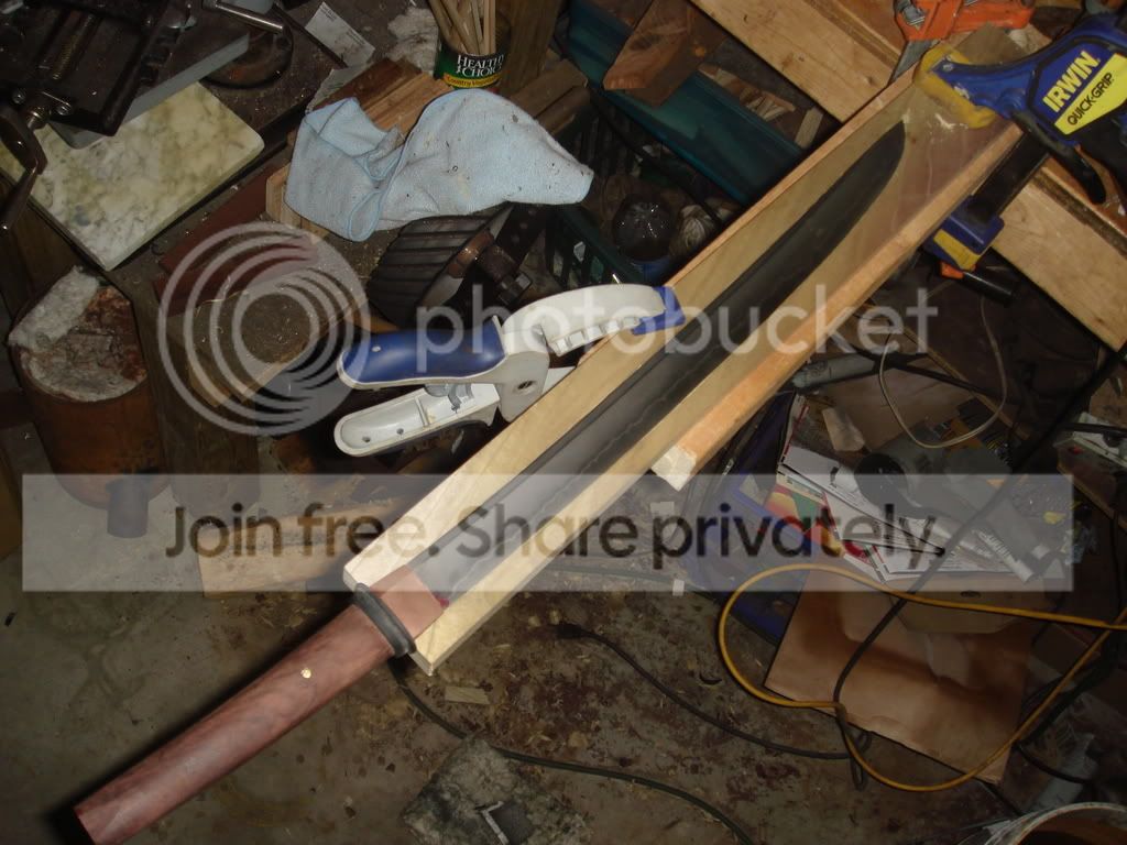

it finally fits!

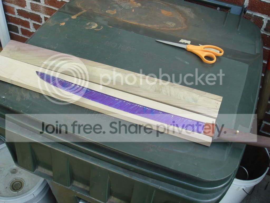

lining it with buckskin
one last fit before glueing
roughed to shape
Polished up fittings (micarta and horn)
tada! okay... so it still needs work.. but that is as far as i got
this carving took me forever there will be a collar on the saya (and no there isnt a gap between teh slabs... it is glue)
the sheath is still kinda fat... and the blade stick a bit.. but it will "break in" very nicely.. that and when i get the glue off the blade...
thanks for looking!
