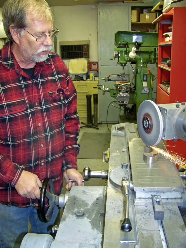

No one stone will work for everything. I like the norton stone best myself especially the 5sg seeded gel stones but these are really expensive about 80 bucks from a standard supplier. I have bought a few off e bay for about 25 bucks apiece. You will want at the very least a soft stone for hard steel and a hard stone for soft material. I find that a 46 grit will leave a finish that I can see my reflection in. and a 80 grit will leave a good enough finish on damascus to go right into the etch.
the down side to stones is that you are linited to taking small cuts <.005 at a time. I normally take no more than.002 at a time when HOGGING off material and .0002 or less when finishing. I in feed about .020 at a time and work across the piece from one side to the other before setting down for the next pass across my work. I have my table set for the fastest x feed that it will do. on the last pass let the stone "spark out" that is keep going back and forth across the piece without using any down feed until you can detect no sparks from the stone.
good luck if I can help feel free to give me a call.
I take about .015 to .020 deep at a time and get excellent results.
feed is about .02.
I know that sounds strange and unusual but do a search on www.practicalmachinist.com for details. it works and I get a great finnish.

Good link, Michael. I grind the same way but dry and take .005" down, with a .025"+/- infeed. I get a pretty nice finish with a 46 grit wheel, when I drop back on the infeed.
