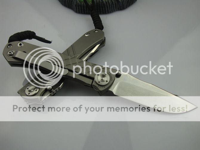

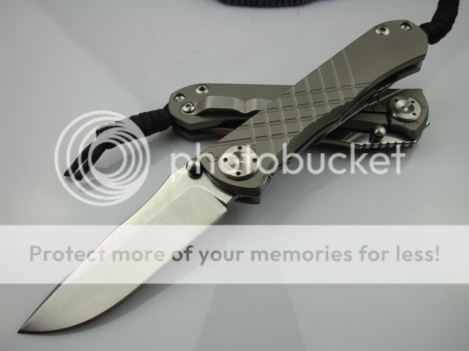

Yep it's true guys. :barf:
Edit: doesn't look like they have the classic MM Sebenza copied. I just took a quick and didn't see it. I think it's just a small version of their crappy 21 copy.
Yup, those are the ones I saw. Notice the blade finish is kinda coarse, and the clip is a travesty, but not everybody knows what to look for like we do. These are gonna hurt a lot of people.
Hopefully people will stick to trusted sellers and authorized dealers.
And ya you can totally tell by looking closely at the knife. The machining screams cheap.
The blade is off by a lot but it's still going to fool a number of people out there, shame we have to put up with this sh*t.
How can you spot a fake? Can I see side by sides or something?
The hollow grind is not as high on the fake one. The grind on the real one comes a lot closer to the thumb studs.
The upper grinds and swedge look soft and not as sharp or defined as the real one. Looks cheap.
If you look closely it looks like there's a little dimple on the lockbar where the detent ball would go.
Also by looking at the position of the dimple I highly doubt that it has the ceramic ball lock interface.
