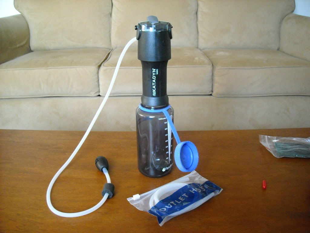

Another vote here for the Vario. For any lengthy fishing, hunting, camping, or hiking trip it goes in my pack for sure. The ceramic filter is awesome. Definitely extends the life of the main carbon filter and is easy to clean in the field with a green scouring pad. I also love that it will attach directly to my Nalgene bottle.
