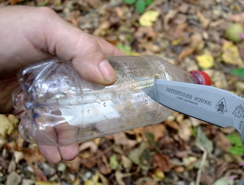

I was taught how to make a water filter using bamboo, gravel, and sand in situations where large particulates and insect larvae needed to be removed when I had no way to actually purify the water to at least minimize the risks, and also even as a precursor to boiling in some cases. While drinking unpurified water is never appealing...neither is dying of dehydration. This is one reason why a sharp point is an important feature to have somewhere in my "tool kit" in the field, to make the small holes for the filter.

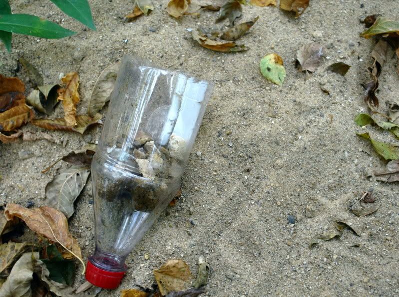

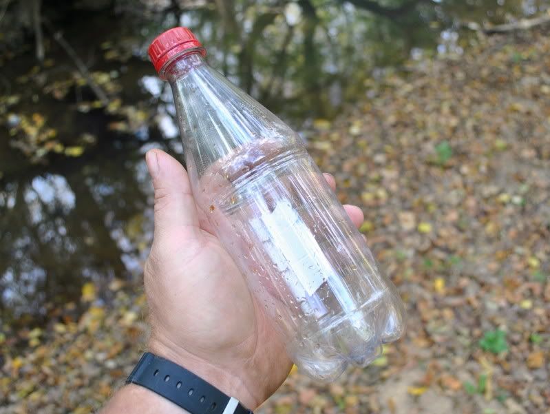

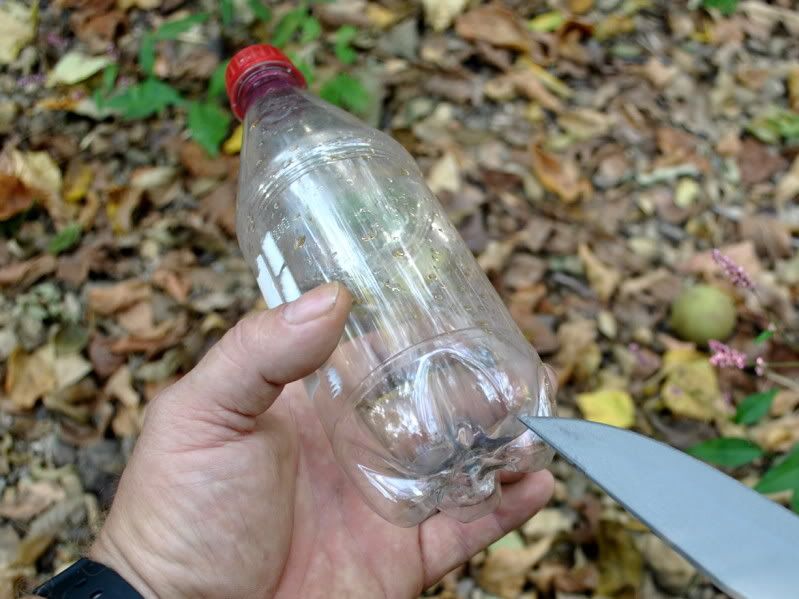

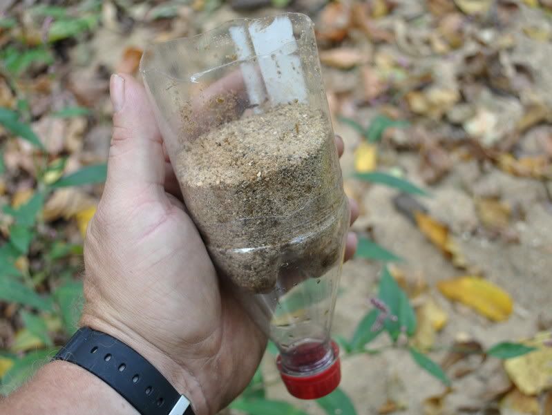

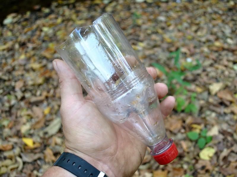

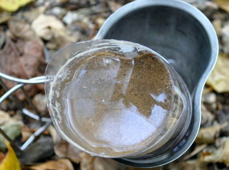

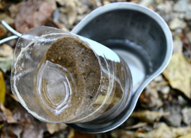

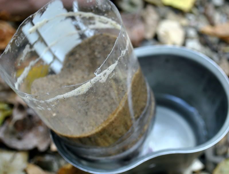

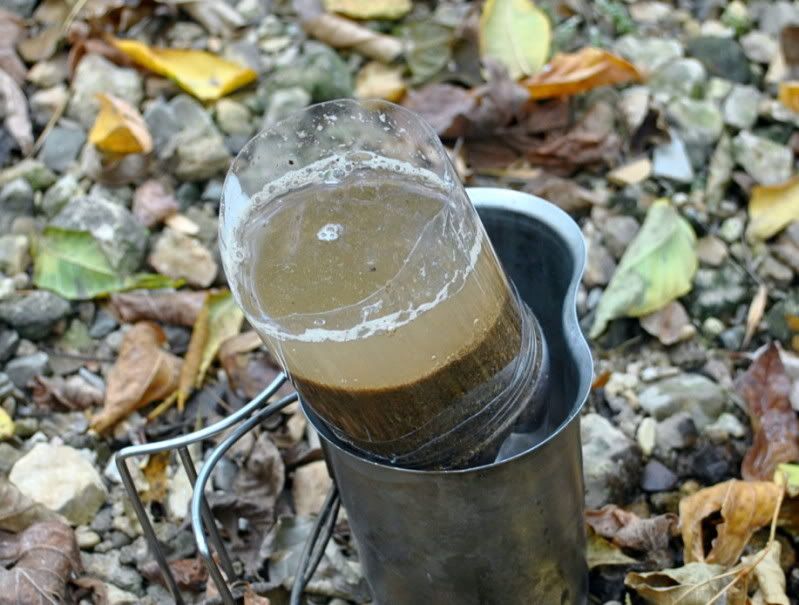

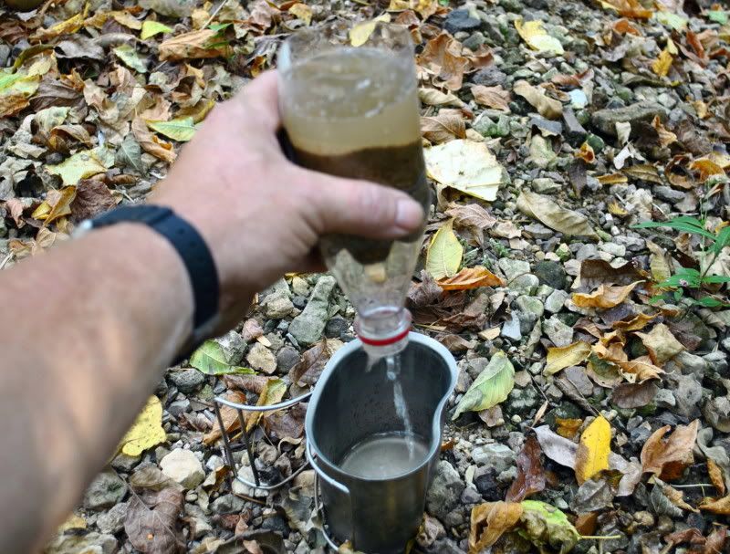

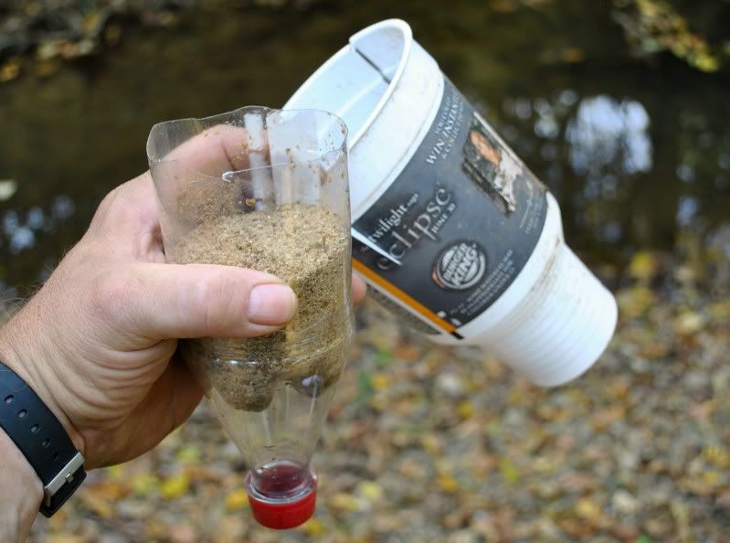

I got the idea today to play with this using a plastic bottle.

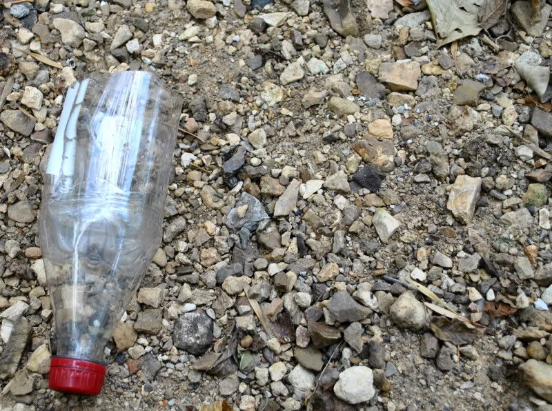

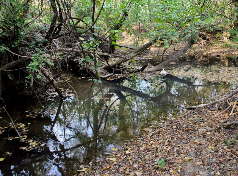

I was on a sand bar in the bend of a creek so I used small gravels and sand from the immediate area.
I just used a broken cup I found in the area as a dipper.
End part 2 of 3

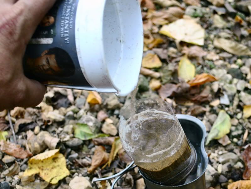

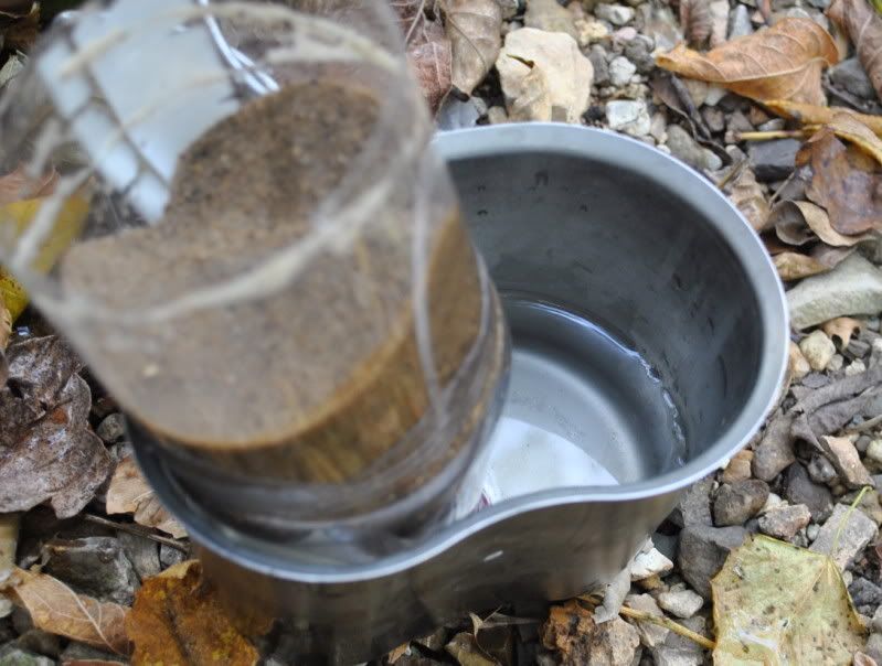

The first run through was cloudy with sediment like I expected. However there was a film and a foam ring that developed that I think was from something in the sand.
But even though the ring remained on the bottle, the water did get clearer after a few runs.
Very interesting. So how much clearer would you estimate it got? That filter should have removed a large portion of the "heavy" items. Do you think a boil after a filter process like that would work? Moose

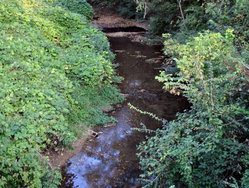

To clarify here, there are actually two different creeks in this set of pics. First pics with warning sign taken at Stringers Branch second pics and filtration done on Mountain Creek. There are no warming signs on Mountain Creek but probably should be with all of the residential areas around it at this end.
Ok..there is no industry on Mountain Creek and all of the old farms have been apartment complexes for more than 30 years now so a boil may well have taken care of anything. However if I had been preparing this to drink and had the means to build a fire and the time to do so I would have also burned enough wood to make a layer of charcoal in the filter too just as a precautionary measure. I would have also cleaned the dipper better or looked for another one :)
