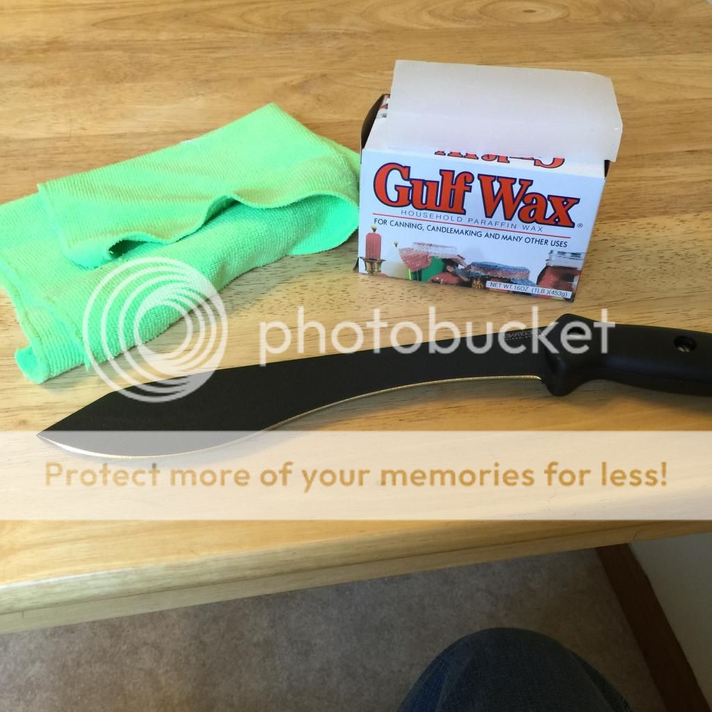

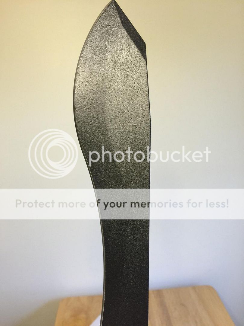

I've been doing this for a little while now, and I have to say it's become my favorite way of protecting my blades. I got the idea from work. We wax our bandsaw tables for lubrication, and it got me thinking of a knife application for the same purpose as well as protection. Try it and you'll be as impressed with it as I am. It will work for both coated and stripped blades (I have not done this on a blade with a patina, so I don't know how it would affect it). When finished your blade will have a really nice shiny luster. I had the perfect chance to show how I do this on my new BK4. I find this technique comparable to tuff cloth, but better. You'll be amazed with the lubrication qualities.
Stuff you need. Paraffin wax blocks, and two no fiber/low fiber towels.

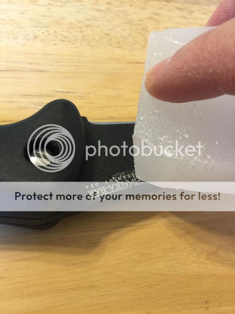

Start rubbing on the wax.

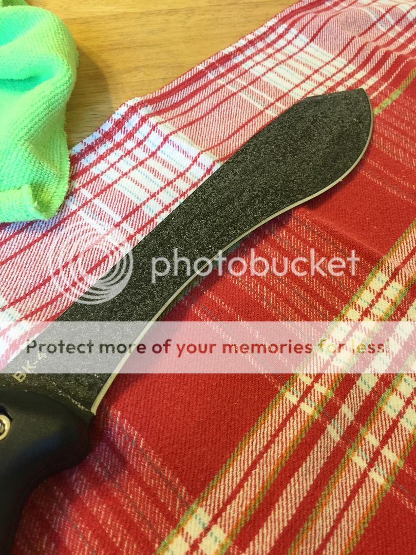

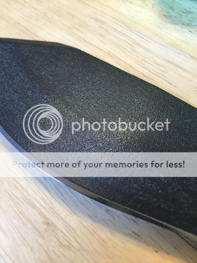

Use a corner to rub into the etching.
Make sure to rub it into your edge, too.

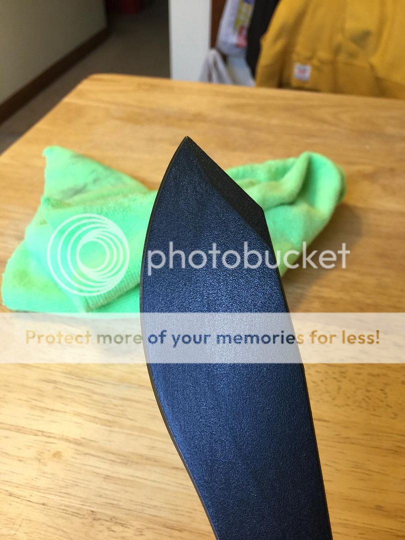

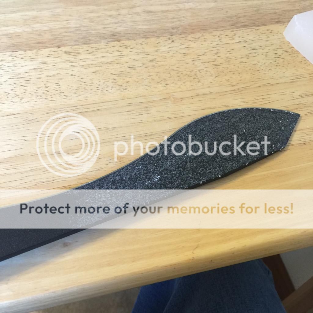

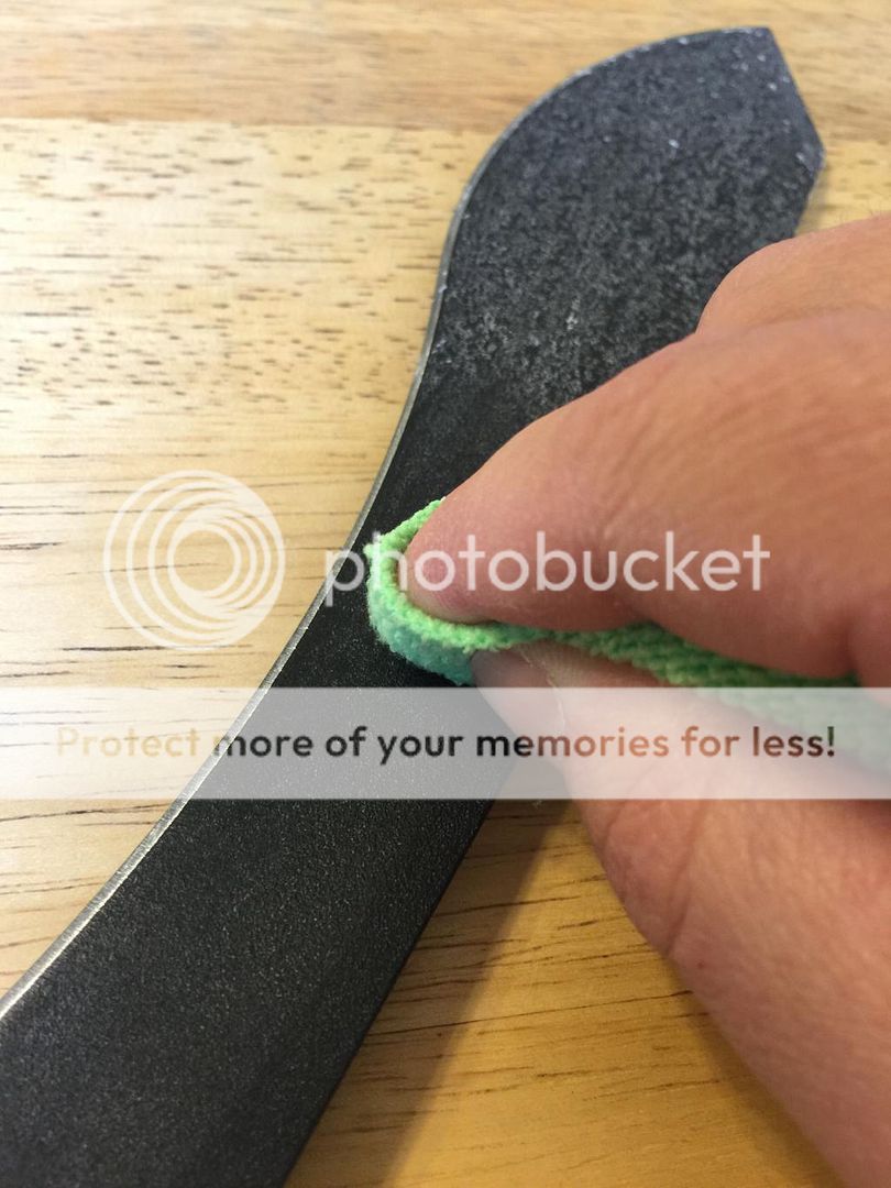

After you thoroughly coat the blade start polishing it off. Do NOT use any type of paper towel. It will leave a ton of fiber in your wax.
If you have a textured coating there will be a whitish looking residue. Don't worry. We will get rid of that later.
It's best to lay the knife on the other towel when waxing the other side.

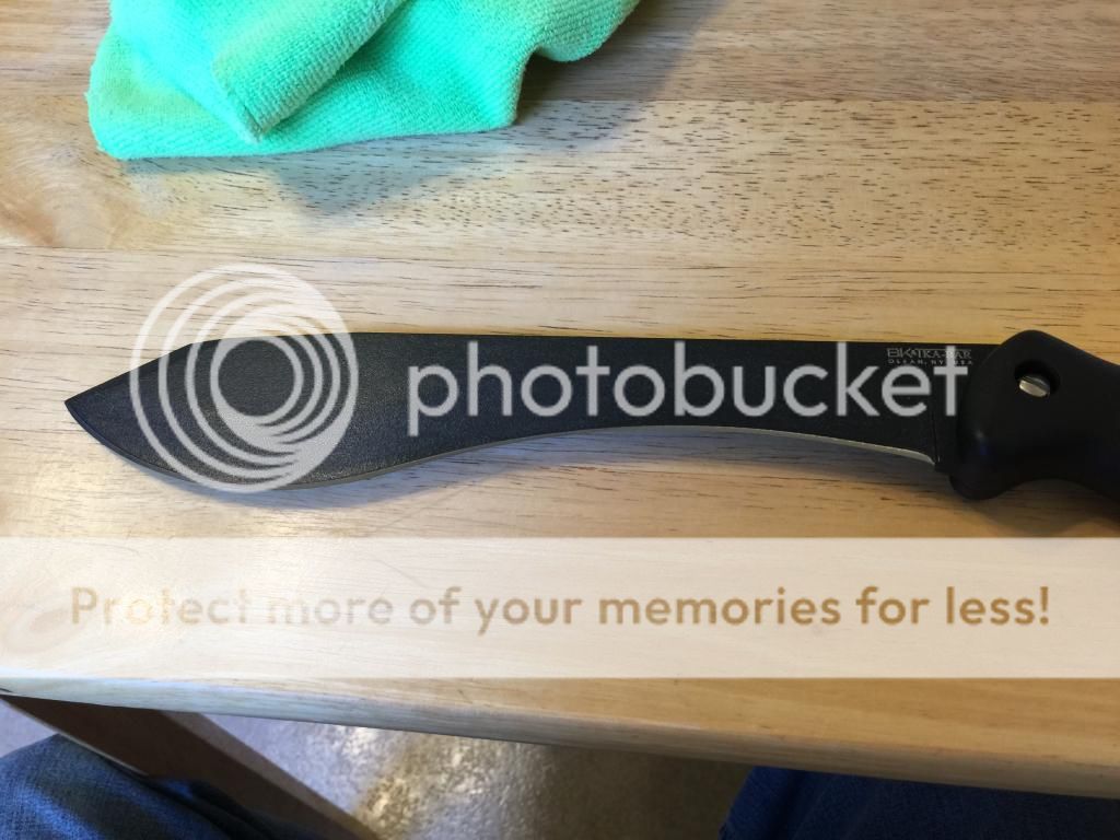

Last step is to add a little heat. You can use a blow drier for this if adding heat scares you. All you need is just a short amount of exposure (nothing to endanger the heat treat) to lose the white-ish residue, and make the wax shine.
Try this. I hope you like it as much as I do. It's a lot better, and way more cheap, and practical than tuff cloth. It's also food prep safe.
