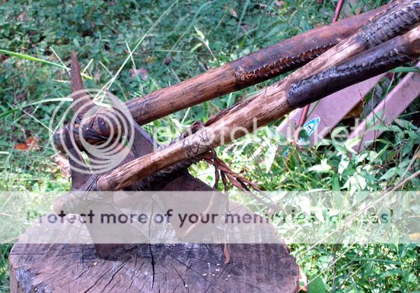

I feel your pain, I am rough on handles( cause I don't throw very well) Here are some wrapped with rawhide, it is tuff as nails. I also use the "Baseball" stitch which actually predates baseballs.........Randy

Nice stuff Randy, we love the same sort of look. I am/was a sailmaker by trade, the "baseball stitch" is actually called the herringbone stitch ;-))

Well it won't be as nice as some of the hawks shown, or Pipeman's work, but you could go to the Thrift Store and buy a used braided belt. The leather is already cut into strips. You may have to wet it to get the marks out of it. Taper the starting end at the head and place a small brass tack. Wrap on down and taper and tack the opposite end. If you break your handle, you can reuse your wrap. I know this is a poor man's fix. A different way, although it would not look as nice, a leather wrap then a piece of bicycle inner tube over the wrap would protect the wood. It's just what you want in looks. If you had done the rawhide method of wrap, and the handle broke, you could maybe soak the stitched rawhide, pull it off as a tube, and slide it back on the new handle.
