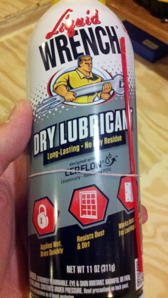

I love wd40 I buy it by the gallon. But this stuff caught my eye. I'm going to try it soon.

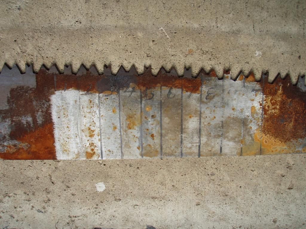

I thought it would be useful to actually real-world test various lubricants/protectants. Note that this was a corrosion test, not a lube test and involved only what I had in my garage at the time. Test was begun in the spring and used an old crosscut saw as a baseline. The saw was belt sanded to remove all rust and segmented for the various compounds. The steel on either side of the marked off areas was left unprotected. The saw blade was then left on my Virginia woodpile exposed to the weather for a couple months. Note that ALL compounds provided some degree of protection and unprotected areas rusted up (as you would expect). Numbers 9 and 10 were combined, since the WD-40 was the thinnest and ran into the next segment. The results speak for themselves.

I spray WD40 on garden tools to protect from rust and it gums up in a few weeks.
I never use it as a lube and I don't use it for rust protection on anything I care about ( ie guns or knives)
I use Militech-1 for lubrication and RemOil for rust protection.
